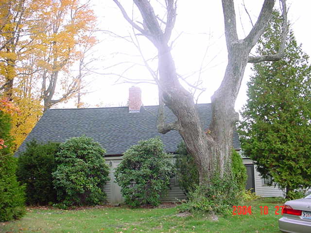

Put a long cable on the broken off part and pull it down with your tractor. make sure the cable is long enough to keep you out of the way of it falling on you. I wish I could show you what I have been doing to a tree that is 20 feet from the front door of the farmhouse I am rebuilding. Here is a picture of the tree before I started disecting it. The base is about 4 feet in diameter. it is a very old ash tree that keeps losing branches. I've been pulling the branches down using a large 1" rope and my tractor. The left side of the tree is now gone. Some of the right side is also missing. The big Arborvitea tree to the right is also missing now. I pulled that one down with my tractor also.
