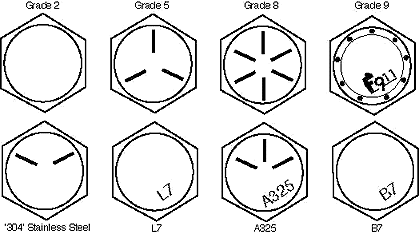

I should have said where the front axle housing connects to the cv joint housing. there are 8 or so bolts and three broke about 2 inches into connection. are these extra hard bolts or can they be drilled. what I need is a diagrahm of the front axel assembly.
   / broken bolts again #2
The marking on the head will tell you the hardness
If this is on a Century and they broke, they are likely the long bolts that go through the spacer block to make the axle wider? They were initially sold with a lower grade bolt and many of them broke. They tend to be pretty easy to extract. Remove the remaining bolts first and take that portion of the axle apart. Replace with grade 10.9 and replace the dowel pins so things never have a chance to get moving in the first place, which tends to loosen up the bolts. Years ago Branson (same manufacturer as Century - Kukje) went through this and we spent a few weeks traveling our area and replaced every bolt on every affected front axle. Since then, zero such problems. Do both sides. Not a hard job generally, although removing broken bolts is never fun.

it's a century there's about 8 of them and the 3 lower ones broke. i'll give it a try tomorrow
