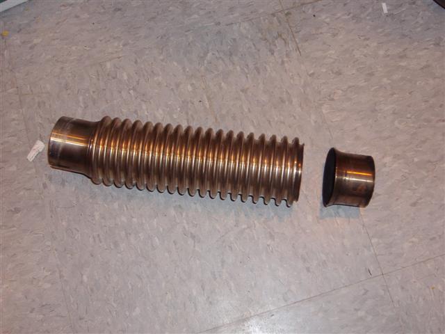

I have about 19 hrs on my tractor now and while I was tring to seperate dirt form rocks with my new heavy duty grapple bucket. My tractor kept on getting louder and louder up on further investigation I felt around the back of the muffler and fould a flexible pipe that connected from the exhaust manifold to the muffler . It was broke in half I hope this part is easy to find through an auto parts ? I am not sure if it is repairable. David.

I went to three automotive stores and found a flexible exaust 2" in diameter and a 2" solid exaust pipe and a couple of exaust clamps I fixed the exaust leak. The automotie parts wer't as good a quality as the old parts. I will try and contact Ingersoll Rand to see if I can get a replacement part. David.

Here is the resized pic

   / broken exaust. #6
From the picture, looks like all you need is a little welding done. What am I missing?
   / broken exaust. #7
I agree, a little mig or better yet tig would do ya

   / broken exaust. #9
Coincidentally, I got a JC Whitney catalog in the mail last night. They carry stainless flex coupler kits (like your picture) JCwhitney
