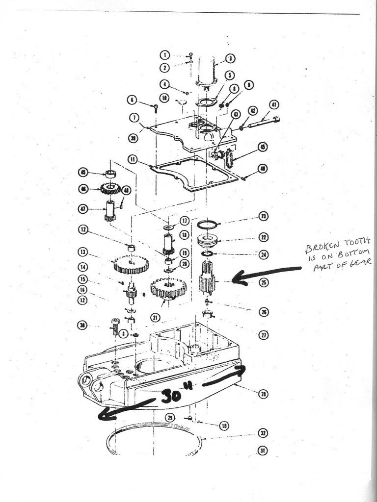

Well, I've gone and done it. I broke a large tooth off a large gear, the "pinion rotator drive" gear that rotates the turret on the Powers PM-300 6-ton crane on one of my International Loadstars.
It's made of pure Unobtainium, so it HAS to be repaired, or duplicated. Does anyone have any experience with repairing a broken tooth on a gear? It's a straight-cut gear vs. helical, so that might simplify things somewhat.
I don't know the exact composition of the gear, but it's a steel alloy of some sort, hardened. Can the missing tooth be built up with MIG or TIG, then machined, then hardened? Should the gear be softened prior to welding and machining, then the entire gear rehardened? Or do I have to bite the bullet and have the entire gear duplicated from scratch?
Any help would be greatly appreciated, including any contact information anyone might have for any machine shops that might specialize in this type of repair.
Thanks, John

If the gear hasn't been completely destroyed, have the machine shop check the hardness, or check it on the mating gear(s). That way, you won't have one of the gearset harder or softer then the others.
If the old gear isn't completely destroyed, a machine shop can use it as a pattern to duplicate it.

I would seriously consider having a machine shop dovetail a new tooth into the gear. If they need to weld it they can just tack it in place at the ends. That way you don't have to worry about retempering or anything. They should be able to test the hardness of the existing teeth and use a suitable piece of bar stock for the replacement tooth.
By the way, where's the photo?
Good luck with it, I'm sure you'll have it going again in no time.

Thanks for the reply Roy. No, the gear isn't completely destroyed, just one tooth out of maybe 6 is broken off. I'm still wondering if I can get away with having this gear repaired or if I'm going to have to have a new one machined.
Here's a scan from my manual showing the gear in question; there's a blown-up picture 2 posts down.

Thanks Gary, I never knew about the dovetailing approach, sounds like a likely winner. So building up with welding and then machining isn't really one of the approved approaches?

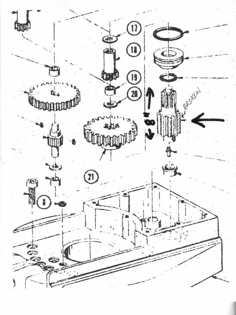

Here's a blowup of the gear.

Have you got a price on a new one?
Just guessing that it looks like its made on maybe a 2-3" piece of round bar stock. Welding or dovetailing could work, but I'd sure check what a new one goes for prior to patching it. Gear teeth are usually "hobbed" by a special cutter. A simpler endmill could be ground to match the teeth and recut one at a time. This is what a local shop will probably do.

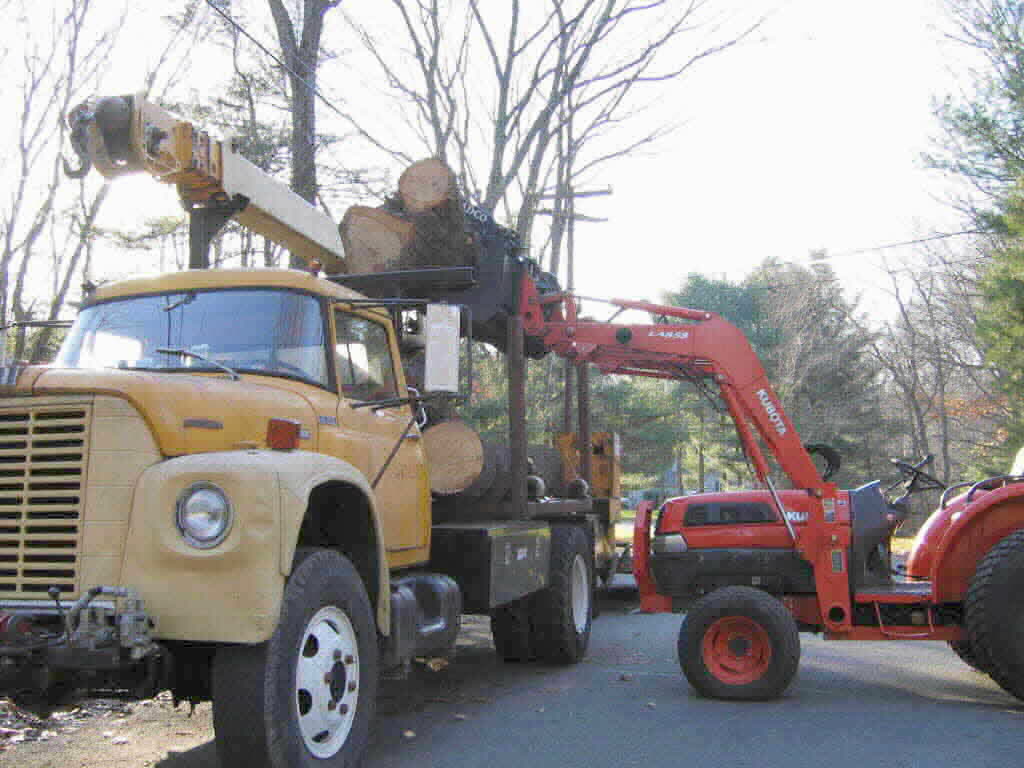

Here's a picture of the old girl, getting loaded up by the Kubota 5030 "tree-bota". She ain't pretty but she's paid for, and she's a BEAST. She'll carry 16,000 lbs. of logs without complaining. And I went through her from stem to stern when I got her, replaced everything, so she's safe. I just never had a chance to put any lipstick on her. /forums/images/graemlins/smile.gif
GVW 26,000 lbs., which is nice, just under CDL.
