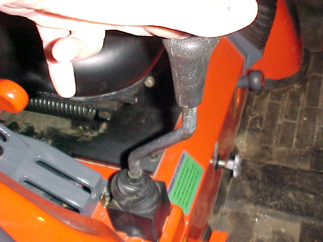

Hello, I just bought a Kioti CK 25 with a Bucket loader and Woods Backhoe. Today is the first time using and whatever keeps the Joy Stick (for bucket loader) from swiveling broke.
Wondering if anyone knows what may be the cause of this???

Not sure I understand the problem. There is a latch at the bottom that keeps the stick from moving, it's a push-in pull-out, brass colored lever. Is this what broke?
Or, do you mean the joystick itself is broken and won't operated some or all functions?

The joy stick being offset in design must have something like a keyway or something to keep it from rotating. This is what mine is doing...it will turn if you don't hold it in position.
Thanks
Bruce

There is a nut on the end of the joystick under the rubber boot that more than likely came loose.
You will have to loosen up the bolts holdind on the joystick body that way you can pull up the rubber boot and you will see the problem. very easy fix.
   / Broken Joy Stick (Swiveling)
Problem solved!! Thank you for your input.
