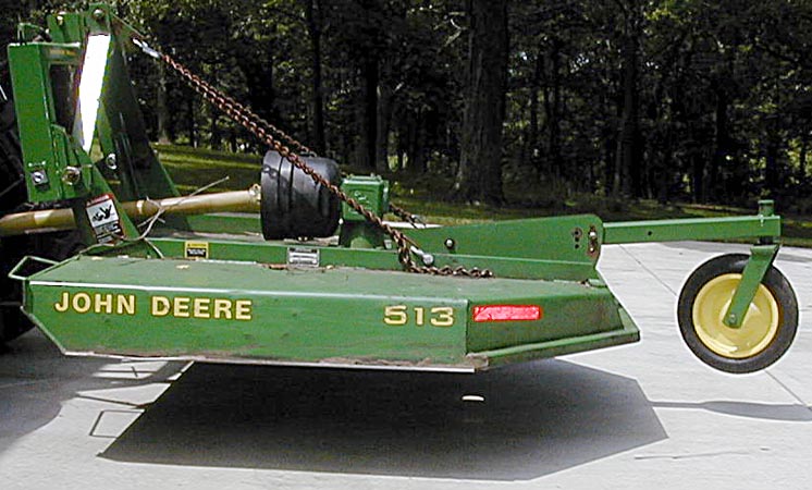

Mine is level at transport height. A pic shows the rotary cutter (brush hog) Deere variety 5'
At mowing height, the chains shown are loose (I replaced the steel straps with chains and find it works better with my quick hitch (Deere I-Match).

Thanks for the responses. The wheel is actually digging into the dirt And not just on turns but straight forward as well. This may sound like a stupid question but when the manual talks about transport are they referring to the raised position or the ground position. the ground is dry. Beenthere thanks for the picture.

If the wheel is digging while mowing straight ahead, the wheel is adjusted to be to low. Try adjusting the rear wheel while the mower deck is at cutting height until the rear wheel is off the ground, then drop it a bit until it takes a bit of the tension off the top link.
