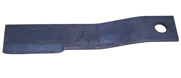

For those of you who aren't familiar with them, the 3PH cutters that are used with CUTs don't have these problems because they don't have stops. Their blades are mounted on a wide pan called a stump jumper and are height staggered so that they can pass over each others bolt ends. They don't need stops.
Hundreds of manufacturers large and small use this tried, true, and reliable system, but not Power Trac, who has to mount the blades on a cheesy brake drum in order to save a couple of dollars. :mad:
Edit: By height staggered, I mean they are mildly Z shaped. See the pic, which happens to be a high lift blade, too.
