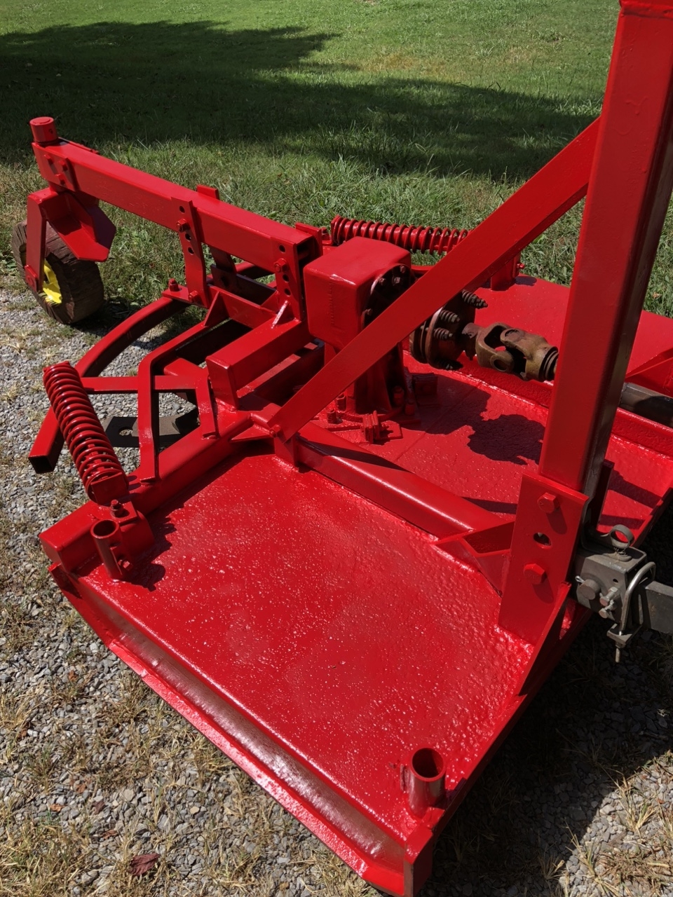

Need to define brush. I’ve got mean, tough brush and hilly ground.
Tried different tractors and attachments over the decades. Hard to beat a good rotary cutter for cost, performance, and durability.
Fresh paint on our 25year old Brown tree cutter.
I like the size of this one. Called a tree cutter?what size is it
   / Brush Cutter #16
Google Brown Tree Cutter. They are very expensive compared to a bushhog, but they are designed to cut that 3-4" stuff. Yes, a bushhog will, but it won't cut a wall of it, without either bogging down to the point the blades don't cut, stall the tractor out, or break something. I dont think they ever made a 4 ft model (or atleast they don't list one of current products). They are awesomeness, but you probably won't be able to use a 5 ft one without some pretty serious front weights. I see one locally (6 footer) for $3,000 OBO, in good, use not pretty condition. New, that is probably close to $12,000.
