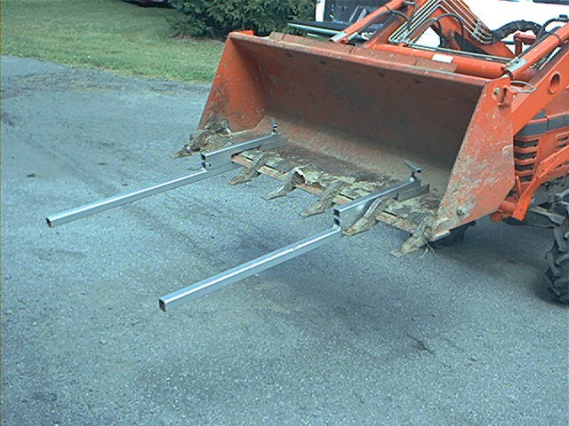

   / Brush Forks #6
Don't know if this will post with the new file size but these are some clamp on forks I made in about an hour from some scrap I had laying around. Not as nice as many I've seen but they work ok and cost nothing but a little time. Think I'll find some smaller square stock that can slip inside the ends so I can make the forks longer when moving brush and other light duty things.......

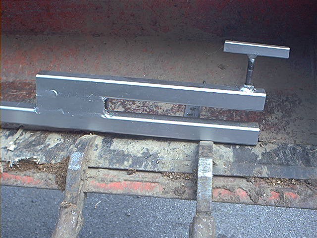

   / Brush Forks #7
close up

   / Brush Forks #10
Gerard,
I made a copy of your forks. My modifications were to cut the tips at an angle and weld some flat stock on for a closed point. To prevent the fork from twisting, I welded a 2 or 3 inch piece of 2 inch pipe where the tooth bar tooth and the fork meet.
Thanks for posting your pictures, I really appreciated it.
