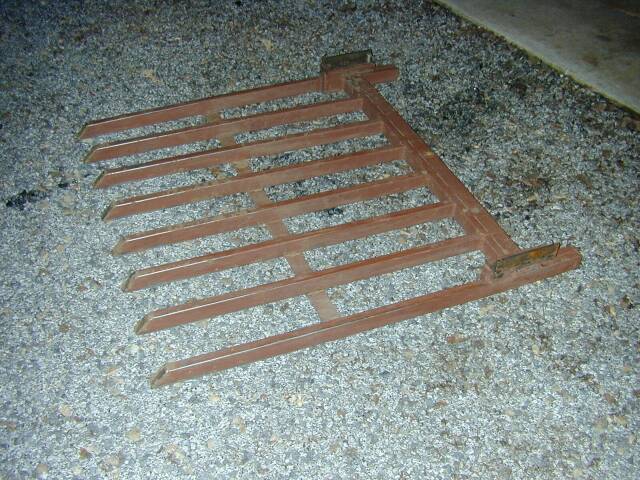

I'm pretty happy with my 1" x 2" x 16ga x 40" long forks. Easy on, easy off with a socket. Weighing in at about 40#.
Current thread.
More pix at ...

Those look great! You're showing pictures of exactly what I want the forks for. I have a pile of small oak logs (12" +/- at the base) that I need to chop up into smaller logs and move over to the "firewood yard". What is your method of attachment? Do you have pictures of it?
   / Brush forks #7
I use the same types of clamps everybody else uses ... 1/2" bar drilled and tapped for 1/2" hex bolt.
