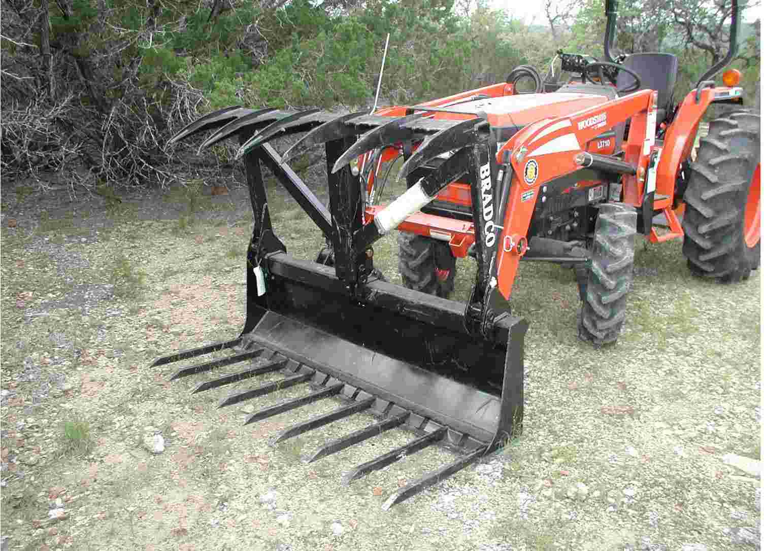

I used this attachment for approx 6 hrs today, and it worked great. I cleared approx 75 cedars that were previously cut. It allowed me to make the piles futher out of the way. I wasn't sure if it would work, but it turned out super.

BBearden,
I've visited Bradco's site before, but I've never seen the brush grapple before. It looks impressive and costly, but I'm intrigued nonetheless. Would you mind telling us where you bought it, and for how much?
Thanks, hess.
   / Brush Grapple
I couldn't find it on their site either. My dealer had a picture of it in their catalog. I basically bought it sight unseen. I paid a little over 2K. You can understand why I was afraid it wouldn't do the job. My dealer is Lanford Equipment in Austin, Tx. You can see it at work in the attachment. Please excuse the dramatic license, I don't travel with the load that high, especially with all those rocks!

   / Brush Grapple #5
For those of us who are optically challenged in North Texas, can you give us some details of how the hydraulics hook up? It appeares the thumb part of the grapple is controlled by the bucket rotation cylinder. Is that true, or do you have to have a remote valve for the thumb?
Thanks,
JimI
   / Brush Grapple
I'll do my best, this is my first tractor, so I'm a bit hydraulically challenged myself. There's one cylinder on the top of the upper "jaw". It is located in the middle. The hydro goes back underneath the tractor, out the back, and into another valve I had installed. This second valve also runs the top and tilt for the box blade. This valve is mounted on a pipe "arm" which is u-bolted to the ROPS. This attachment has a view of the valve I'm referring to.

Brent, thanks for the extra detail. The grapple really looks like a very useful tool for clearing brush. I think it's hard to come up with the best overall tool for that chore. I have land that is mostly covered with postoak and blackjack oak and some cedar. My challenge is normally getting through the green briars to trim or cut down trees. Since my woods is pretty dense and I am not clear cutting, it is a real challenge to move cut trees through the ones I've left standing. I usually end up cutting the trunks several times to make the trees short enough to easily push through the others. With the grapple, I could probably manipulate the felled trees a lot easier.
Could you answer one more question? Can you approximate the length of changout time from the time you start to remove your bucket until the grapple is ready to operate?
