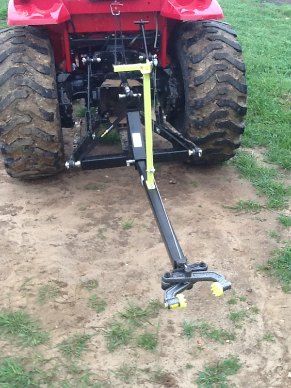

Well I picked up a Brush Grubber HD at Northern Tool. We put it to work for the first time today. Not a bad little piece of equipment. First pic is the BG hooked up, second pic is my wife doing the driving while I was moving the trees...

It appears that it is useful in serving your present needs. Teamwork is an added plus when using it. It saves one from getting on and off the tractor. :thumbsup:

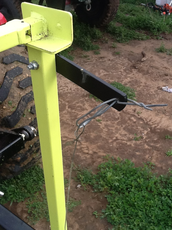

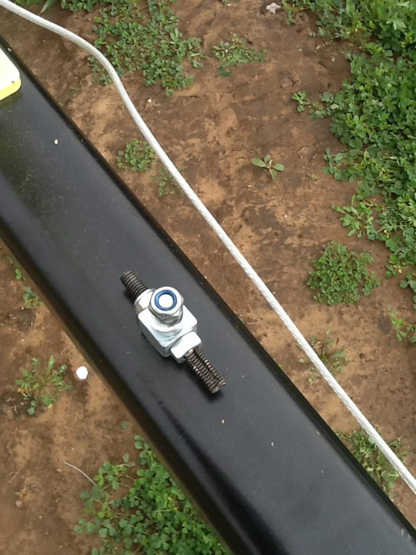

Well, tried out the 2" receiver attachment today. It's nice not having to get out of the tractor. But, the actuator cable broke in about 20 min. Also had issues with 1" and smaller, I think that it may be due to deep mesquite roots. So it looks like I am still on the hunt for the ultimate mesquite up rootererer. Don't get me wrong, the grubber did well but not up to my expectations.

So here is my quick fix and the crimp that the cable pulled out of.
