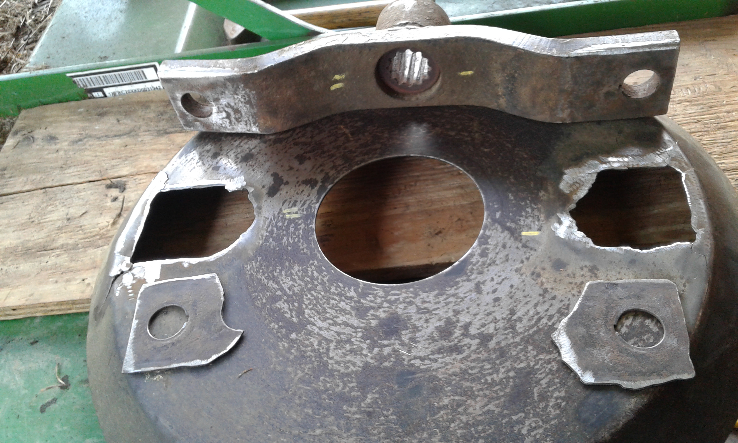

Double checked pan measurements, one I ordered was smaller than the one I need, so I called to see if they had the correct one... no dice. Earlier in the day, I had checked a small brush hog (40" cut) that I've never used, it came with our BX when we bought it, and the gearbox is compatible, and the same ratio as what I was going to buy... so I canceled the order since it hadn't shipped yet, saved myself $256, and got to work.
I opened up the donor gearbox, it's clean, and hardly used, bearings tight, no signs of wear. I'll run it for now...

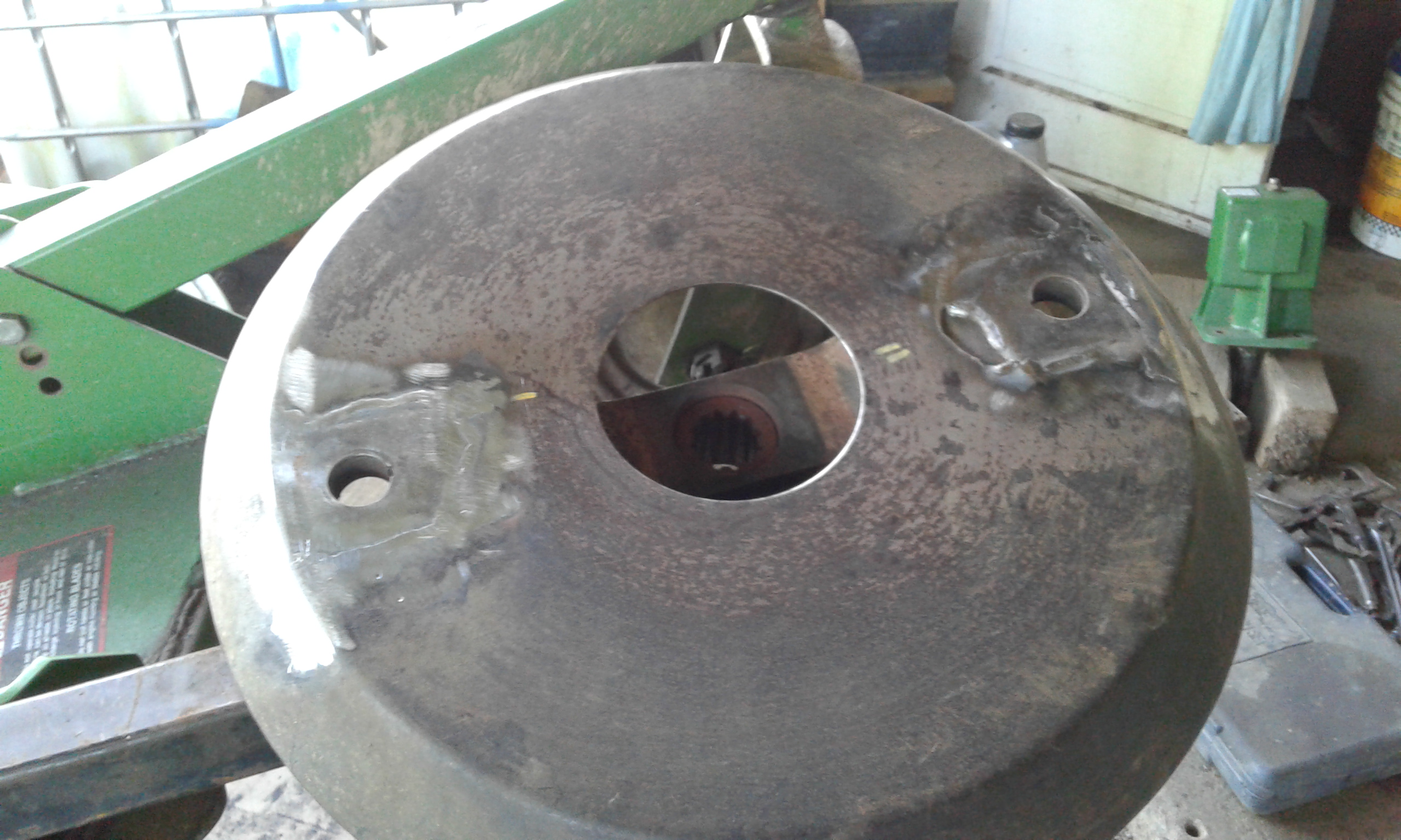

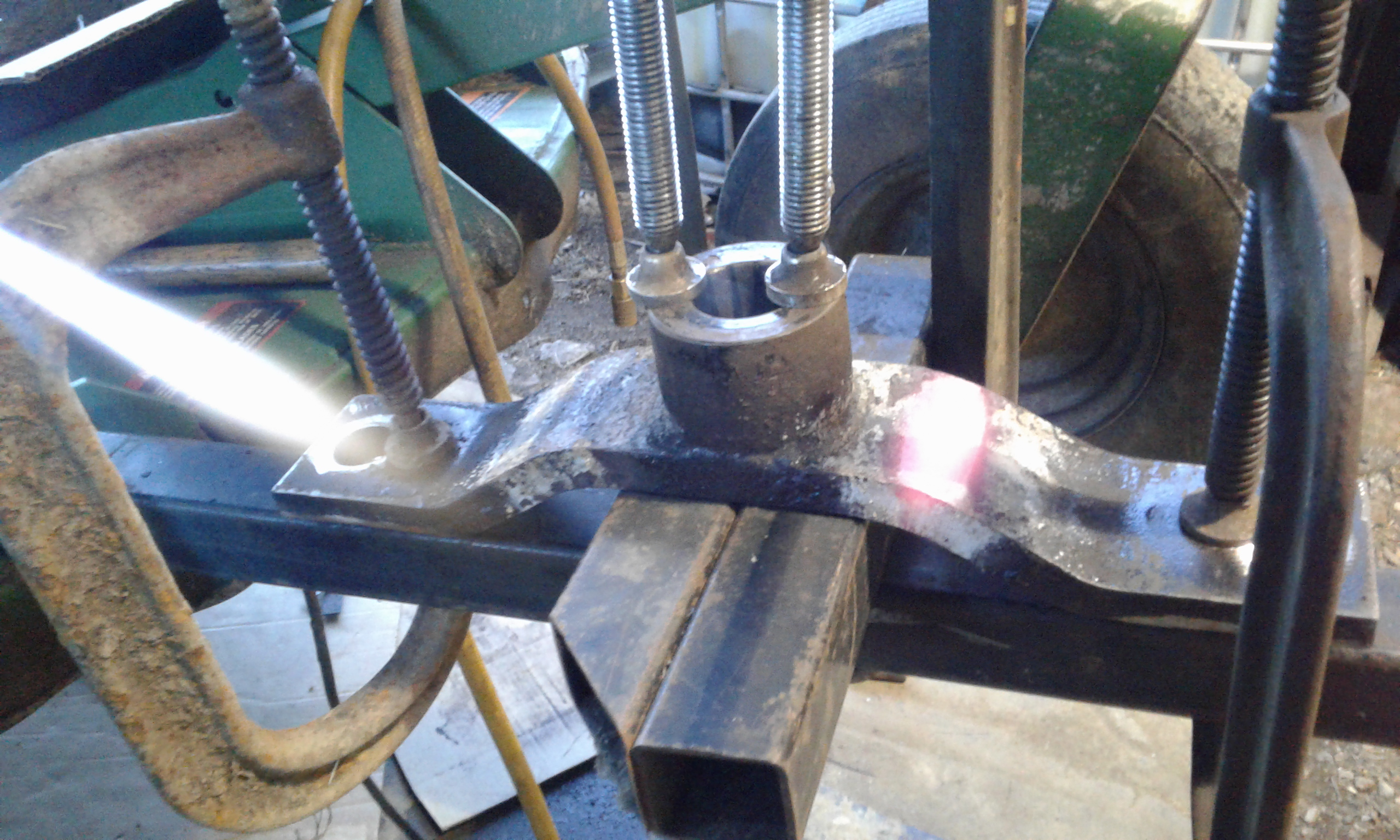

I started repair of the stumpjumper pan. The pan had separated from the main bar that has the center splined part and shoulder bolt holes, and was cracked and broken. I ground out the cracks, straightened the bar, and tack welded it all together. I've got it true within 1/16" or less, both centered and height. Started burning in all the welds, but ran out of MIG wire... bummer. Guess I'm gonna have to run to town in the morning.
   / Brush hog gear box ratio 1.69 vs 1.47
Follow-up report: Repairs complete.
I got the pan welded, welded the main bar back into it, and smoothed up the welds that would interfere with the blades fitting properly. Got it all back together, gearbox oil filled, and took it for a test run about 11:pm last night. Smooth as butter, at all speeds up to WOT. Hasn't been that smooth since it was new. Had to adjust tail wheel hight, due to the blades being closer to the ground again, maybe a little closer than originally due to how much I bent the main bar back down during the pan repair. Regardless I'm happy with the results.
