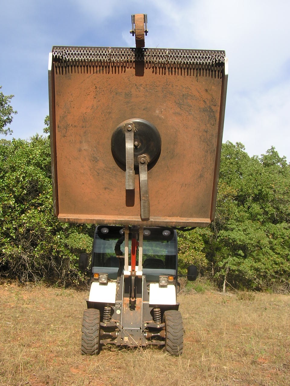

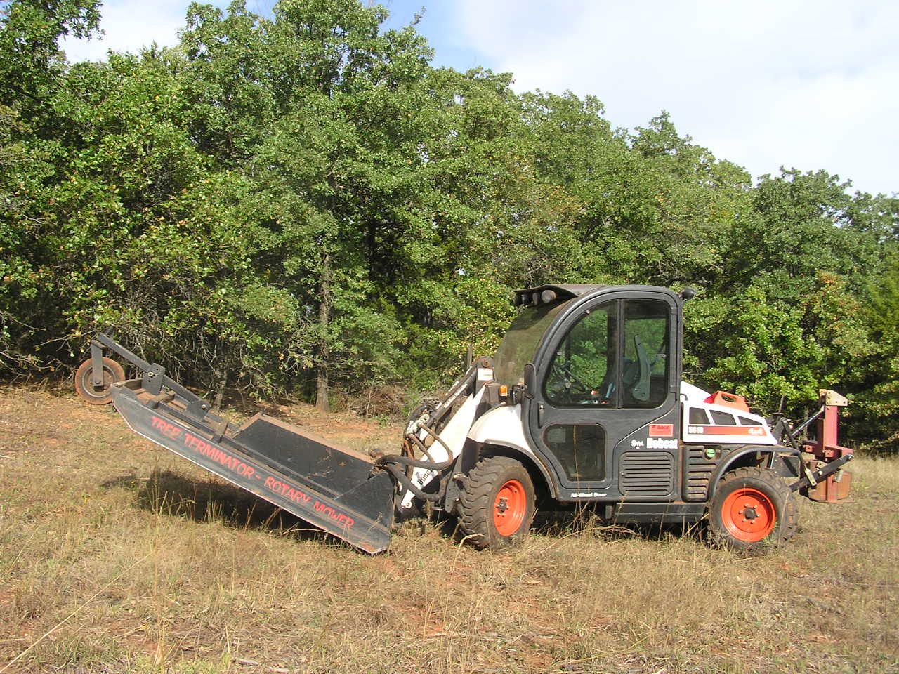

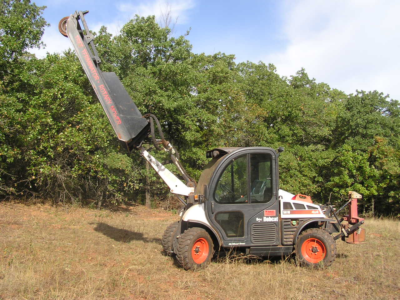

Here is the stump jumper on my 7' brush hog.
Out front on the Toolcat, I know where is all the time. :D
