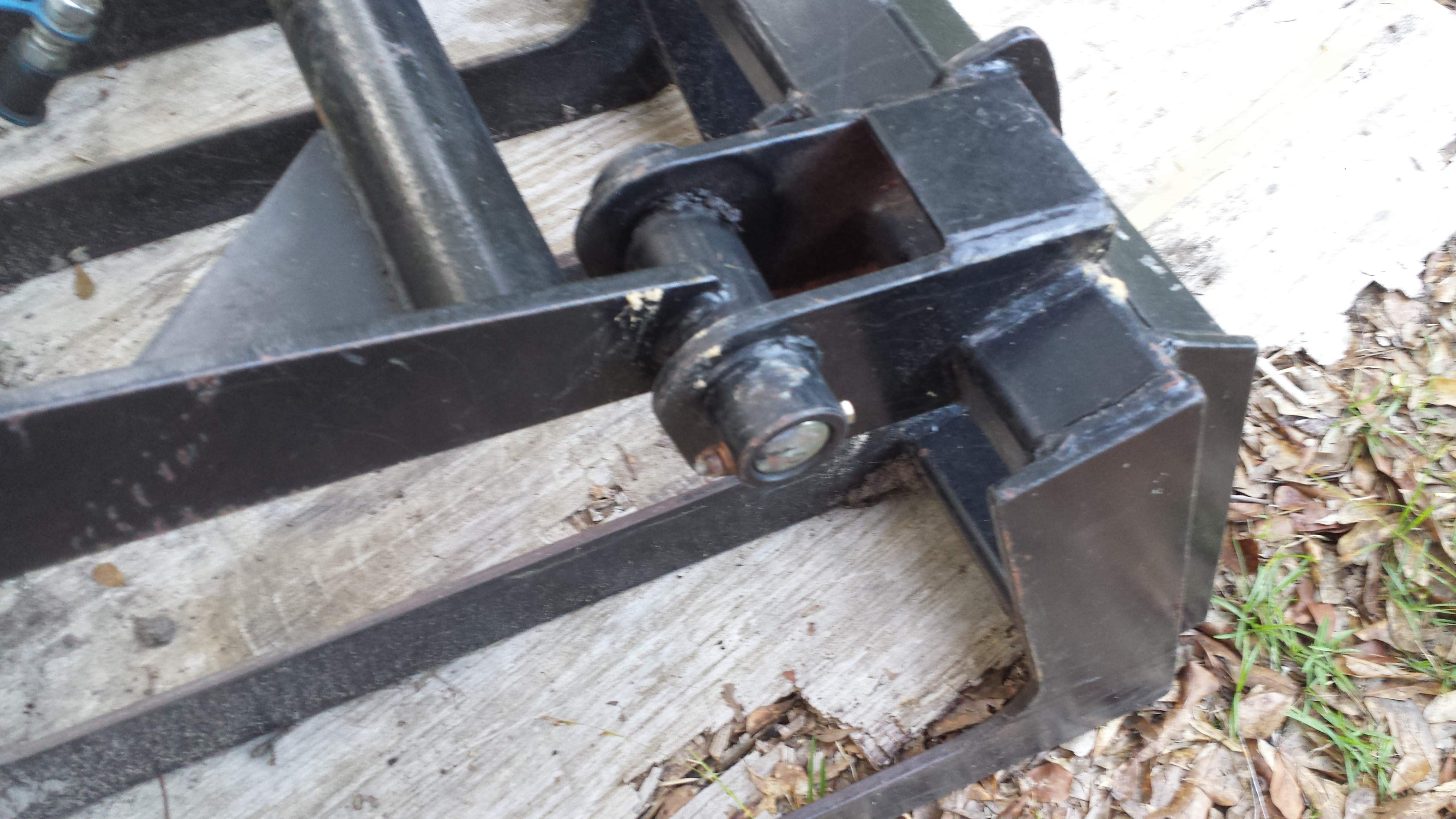

I'm wanting to build a brush puller, and I'm working on the design at this point.
Can someone tell me what type pin and bushing I need. I want to use a greasable pin / bushing similar to the one shown on my grapple, for my pivot arm, only larger.
Just don't know what it is called, so that I can search for them.
Thanks
   / Brush Puller Project #2
   / Brush Puller Project #3
I ordered a greasable pin the same as on on my tractor; then found a shaft coupling the same size and used it for the bushing. After welding the bushing in I had to use an expanding reamer to true up the bushing. The couplings for a
1 1/4 "shaft are over 3" long. For short welded in bushings; shaft couplings are better as they are thicker wall and distort less when welded.
