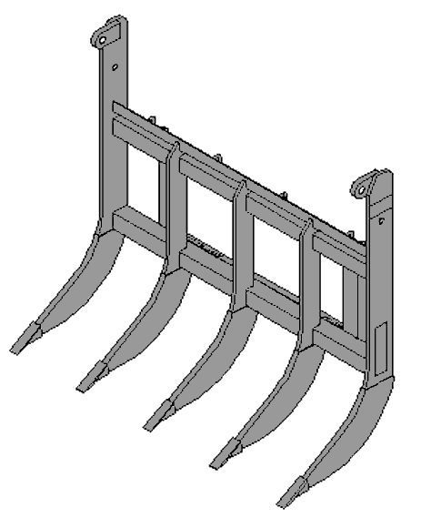

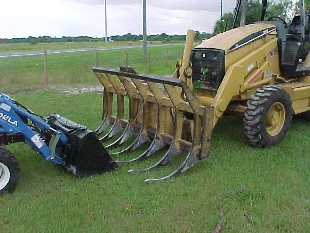

I really need a brush rake to move piles of brush for burning and to shake the dirt off some brush that's already been uproooted. I've been hiring/renting a big Cat 416C with a serious rake to actually get the stuff out of the ground, but it's too expensive for the smaller work. Plus, it's so big there are still plenty of saplings that have to be rooted out, located where it's much easier for my compact to get at them (Brazilian pepper trees will spring right back if cut out).
Attachment shows the rake we've been using. (continued)
   / Brush rake
#2
But, most of the "real" rakes are far too heavy-duty - and just plain too heavy - for my TC18. The 12LA loader has a capacity of 1090# at the pivots, a working capacity of about 750#. I finally found this Worksaver rake (attachment) @ 432# that is tougher than it needs to be and still leaves me with enough capacity to do what I need to do.
It's 62" wide, and comes with some universal loader brackets that will work with my 12LA.
The problem is, they want $1045 for it. I need it, and I have the $$$, but I just can't get my tongue around paying that much for what is actually a pretty simple implement.
I've got 3 choices I can see. (1) Pony up, pay the price and get to work. (2) Keep on looking in an almost fruitless search to find a less expensive one. (3) Make my own. It doesn't have to be as tough as the one they show - I don't have enough power to bend or break something even half that tough.
I know the tractor can do the work - I've flipped saplings out with my bucket, but the rake teeth would be much more efficient. Bucket teeth would help, but then when I try to pick up a part of a pile, the brush won't cradle in the bucket, and just slides off.
So, I'm posting this in the hope that someone may have a better idea, or that someone might know where there's a used one, or whatever.
PS - I've searched the forum, and have seen some well-contructed brush rakes, but all I have found have flat forks like multiple pallet forks, and that just won't work as well for digging into roots.

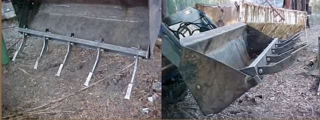

I use this rock picker bucket
Combining a toothbar and rock sifting, this bucket was first used to clean up after a de-stumping operation to restore an old pasture (roots and rocks but leave the dirt), but has now proved that it is also great for loading/unloading log piles (kind of like a forklift). Only thing I wish it had was a grapple. So again, there is no such thing as a perfect implement for every job (dang).

Kent - what's interesting about that one is that the center is so light-duty, which is a good idea - it doesn't have to be as strong as the ends or the digging teeth. Of course, $1,243.75 is more than I want to spend, but that picture gave me some ideas about a good brush rake for compact tractors. It's about the same size as some of the ones I've seen that weigh 1,000 pounds, but it only weights 500 pounds due to those lighter rods and angle in the center. Thanks.
TC35Dforme, we are definitely on the same wave length. One of the things I thought of was to use pins instead of bolts to make it easy to get on and off. In fact, if the frame at the sides of the bucket was square tube instead of flat stock, it would not only be stronger, it would probably be the ideal size to use top link pins. The pins would have some wobble in them, so it might be a good idea to weld a flat plate on the outside of the bucket to reinforce the hole.

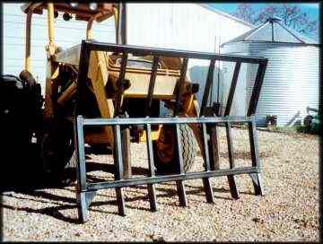

On your original idea, I found a link here in the archives - I was just using the wrong keywords for a search. I found this (attachment) by using "bucket rake". It was built by, and posted by TraderMark on 3/26/01. I'd like to know where he found the scarifier tines with the shallow angle - all the ones I've seen turn 90 degrees.
