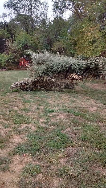

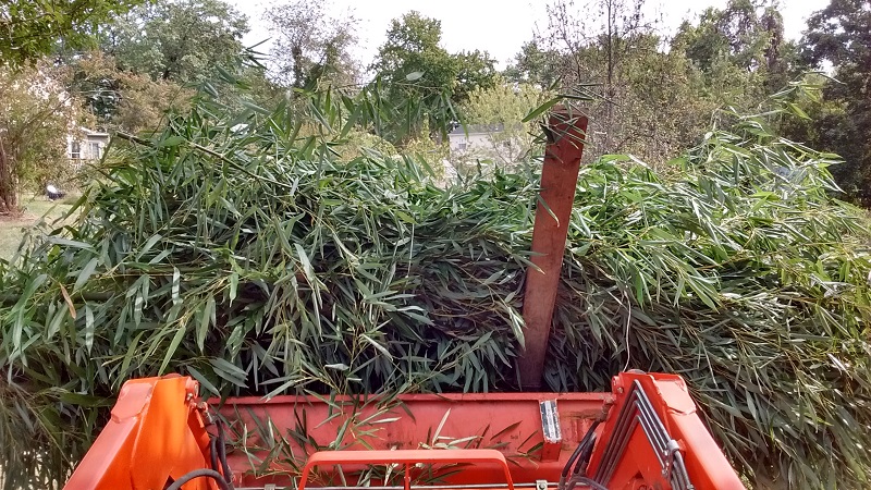

On the Titan Pallet fork link that Newbury provided I saw some debris forks that really looked interesting and with a significant lifting capacity would be very versatile but again the tooth bar would have to be removed. Thanks for input.
Debris forks are great to have. As I mentioned, I keep my forks on 80% or so of the time and I live in woodlands so lots of debris to pick up and dump. They are covered in snow right now, but I made a real simple set of debris forks that attach to my forks (I have to take a picture of that thing).
Anyway, here's what I did:
1. I welded on a receiver hitch to the bottom crossbar on the forks that I use for attaching homemade implements and for pushing trailers around the place. Like this:
2. I got a big length of rectangular tubing the size to slip over the forks and some 2x2x1/4 tubing for the forks and a big chunk of 4x4x1/4 angle iron and a piece of receiver 2" receiver tube I had laying around.
3. I cut two 6" chunks of the rectangular tubing put the forks as far as they would go on the carriage and slipped the chunks over them, sliding them all the way back.
4. I cut the angle iron to the length of the width across the forks and tubing, at full width, and welded it to the two chunks of tubing
5. I slipped the receiver tubing into the receiver, slipped a pin through the already drilled holes, and welded it to the top of the angle iron
6. Next I cut the 2x2 tubing to three lengths about three inches shorter than the 42" forks, slipped a full-length chunk of rebar into each piece to add stiffness and welded each in front and rear, cut the ends so I could weld them shut with a taper, aligned the lengths equal distance from the forks and each other and welded them to the angle iron. They look a bit like this but only three of them and where the tubing goes across the back is the angle iron attaching point:
That's it. Really easy and didn't cost much in materials or time. This is a load of pine needles/pine straw (for the southerners) so you can see it works well. Slips on and off in a trice and is light-weight.
