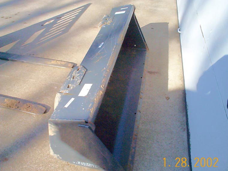

I wondered if any of you know the capacity of my bucket. I have a NH TC33D with a Kasco Uni-Hitch adapter on it, so my bucket is not the standard TC33D bucket. This bucket came off a 16LA loader that would go on the class III Boomers. It is the NH quick attach, 60", heavy duty model.
I have attached a picture of the bucket.

What are the other dimensions?

My 7308 loader manual provides volume data for all available buckets. I would think that the volume for the 60 inch HD bucket for the 7308 would be about the same as the 60 inch HD bucket for the 17LA. Maybe someone with a 17LA manual can help. I will post the volume data for the 60 in HD bucket for the 7308 when I get home.
   / Bucket Capacity #4
SPENCER,
CAPACITY HEAPED : 12.6 CU FT ( .47 YDS )
CAPACITY STRUCK: 10.9 CU FT ( .40 YDS )
BUCKET WEIGHT: 248 LBS
   / Bucket Capacity
Thanks Guys,
I thought it might be around 1/3 of a yard. The guy who delivered all my fill sand said it looked like 1/2 yard. I guess we were both wrong.
