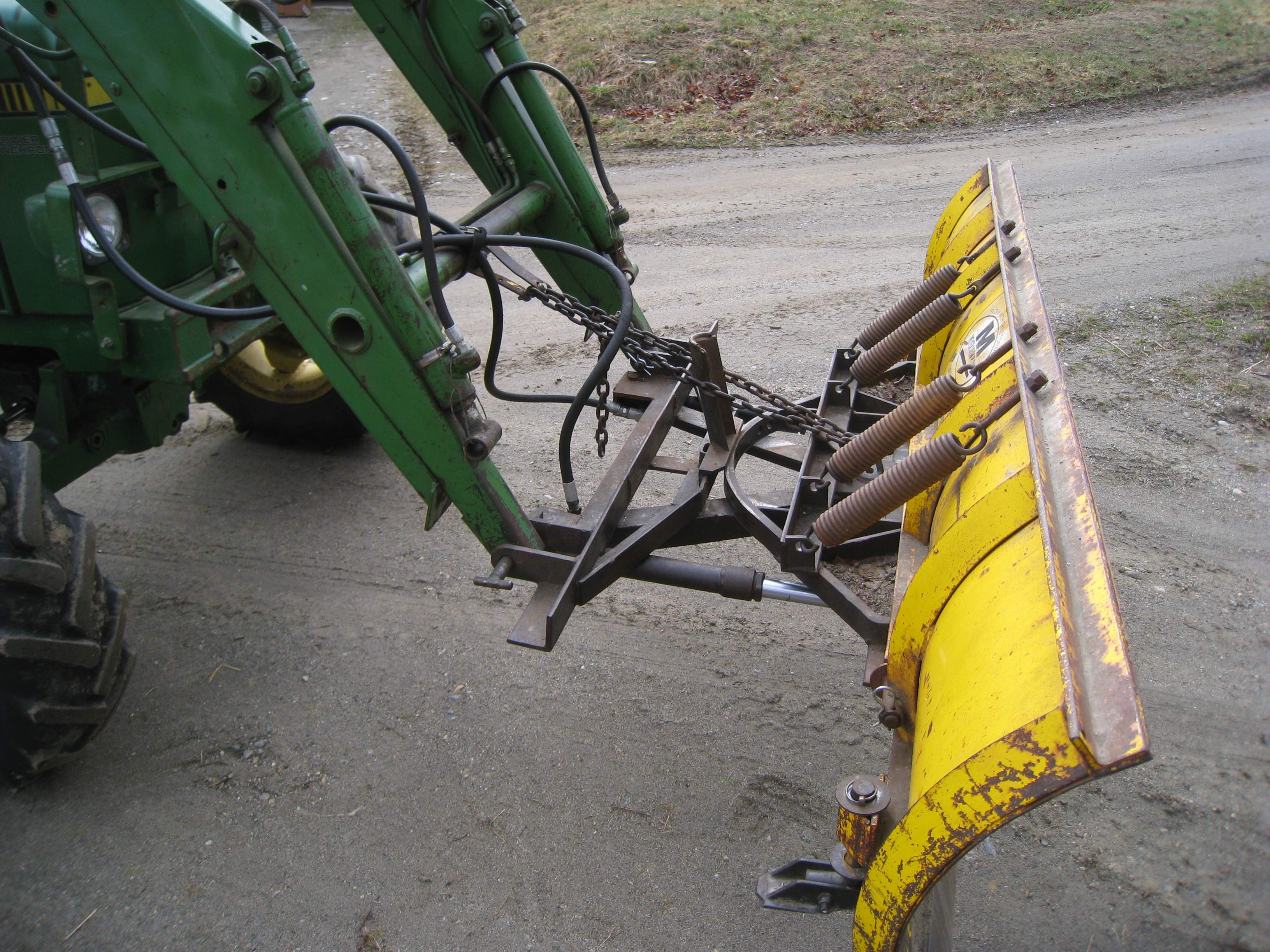

I have seen many buckets on front end loaders that have the bucket curl control connected to lift the blade. The system on our farm only uses bucket lift controls to raise and lower the blade. Would we gain much from incorporating the curl control?

The plow assembly is going to need some repair before the beginning of next winter. I am looking for thoughts about improving how it is currently connected in the process (if possible).

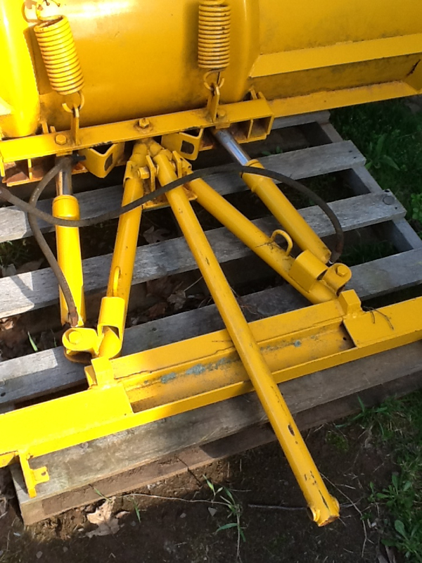

Yes! My plow is hooked up to FEL arms which raise and lower the plow. Use the curl to angle the blade. I removed plow but will send some photos later today if it will help.

Use the lift to lift. Use the curl function to angle. It don't get any simpler especially if you have a joystick

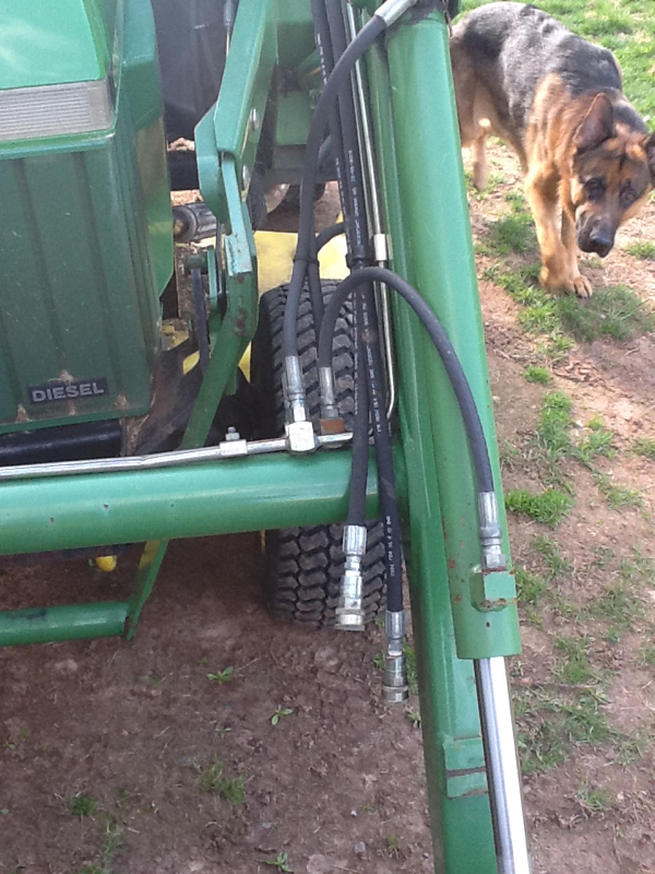

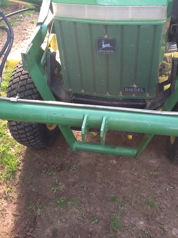

Cray54,
This is how my plow attaches, You can see the center bar on the plow it is pinned to the center bar of the arms. A welder can help with that gives more support than chain. Also have 2 separate lines run to the hydro quick connect for FEL for the plow angle. Works very well. Hope this helps.

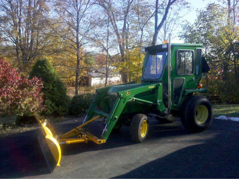

I have the lift and power angle on the joystick. I also have the curl plumbed into one of my remote valves. I found the curl came in handy when you bury the front end and also it gives me some more room in my building as you can curl the blade closer to the tractor
