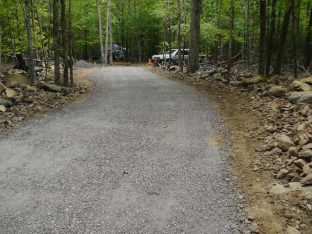

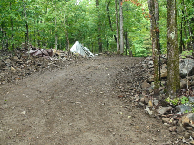

Thanks BeezFun. My thoughts also and thanks for confirming. Bucketdriver.com also has an option to help with driving T-posts (the bending issue) in hard soil. But I still think overall the t-posts may end up a difficult project, with the stronger well pipe an easier install
The front half of the property would be impossible to do any type of post/pipe driving as odds are it was the front of the glacial dumping ground where it stopped advancing. Starting at the property mid point, the rocks start to get a lot less dense in the soil and this is the area I will be working these projects.
Attached are a few pics of the front of the property where I recently completed the driveway. Where I am planning on doing these driving projects, I previously had as mini-x dig a bunch of pits looking for ground that would support a state approved septic system (directed by a soils engineer). There were no large rocks dug up and even few small rocks of any type- depending upon the location. It is like two different properties. But I know there is not a fine dividing line between between the two extremes and that is where I will be working these projects.
The second pic I simply turned around from where I shot the first pic and one can see the soil difference. It is still rocky, but far less so. The rear of the property has no rocks on the surface. The second pic is of my base camp which is located in the area the center of the house will be, which is where the fence will begin. The soil is changing to be far less rocky. The last pic is the driveway completed with the slag finish. One can kind of see the grade I cut. The rocks along the sides are from the driveway build, along with the natural deposits. The whole front half of the property looks like this. A neighbor right next to me had a walk out basement dug facing a pond and said he never hit a single rock.
