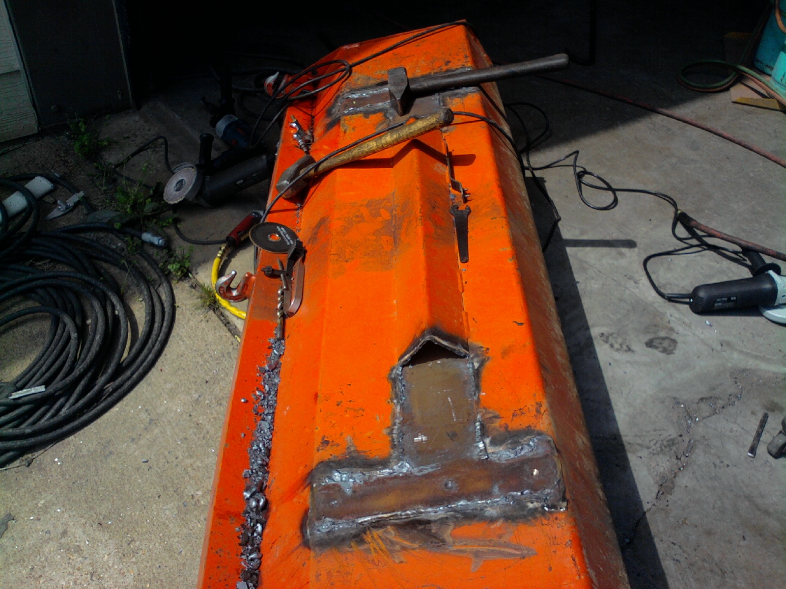

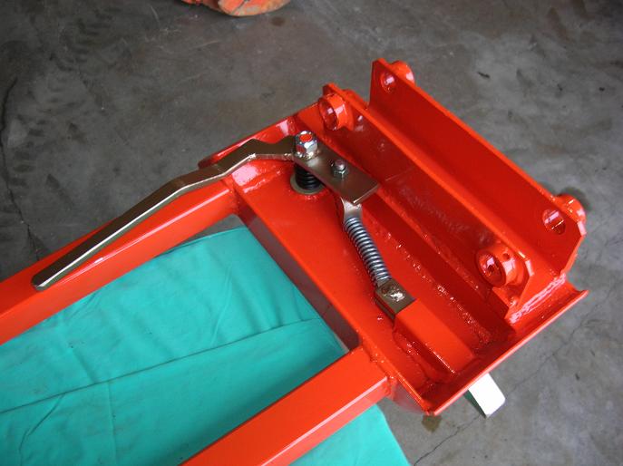

I removed mine used both a cutting torch, and grinder with cutoff wheel. I did gouge the bucket a little even put a couple of small holes in the back off it. No big deal after removing the mounts I just welded the gouges up and the holes shut and ground the bucket back smooth, then welded the new mounting plates on and painted it. looks good as new and works a lot better. :) I also used the mounts I removed on the the loader side of the SSQA I built to pin it back on the loader. Also I forgot mine had three plug welds in the bottom of the mounts so I just used a large drill bit to drill out the plug welds. The first photo shows the bucket after I removed the mounts and the second shows the mounts I removed reused on the new SSQA. If you have any questions just ask.
http://www.tractorbynet.com/forums/build-yourself/170638-my-attempt-ssqa-kubota.html
This is what I was looking for. I have the thread bookmarked, now I probably need a better welder than my Lincoln Pro 100! I'd be willing to pay a few bucks for a diagram of your QA with measurements. I'm sure I'm probably not the only one who would!

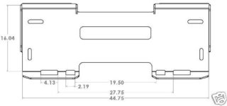

I would give the plans to you if I had any, I just used a buddies SSQA pallet fork frame as a "JIG" for the loader side and designed as I went. Plus depending on your loader arm spacing and such as to were to place the mounts from the bucket. Mine happen to workout were the mounts were far enough outside the locking pin mechanisms.
Also Used info from MWB's thread really good info here.
http://www.tractorbynet.com/forums/build-yourself/141029-tractor-side-shuttle-shift-quick.html
  • universal-attachment-mount-specification-sae_j2513[1].pdf
