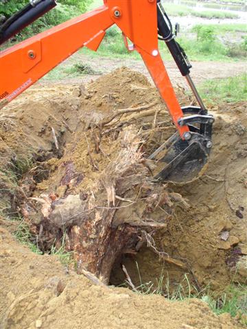

The Woods buckets have a power position pin hole that increases the mechanical advantage by about 1.5x. The bucket wont curl all the way up in this position but it is meant to increase break-out force. This is how I dig pine trees... I use a 12" and dig the dirt from around the stump but leave a bottom shelf under each leader root and then put it in the power pin hole and use the dirt bottom as a fulcrum cut the root leaders by curling the bucket. I've cut/snapped 8" pine roots this way and also lifted the tractor up on nothing but the pads.
If you look close you can see the two curl cylinder pin holes in the bucket.
I have the bracket cad drawings from Woods if you want to use a different brand bucket and make the brackets. I'll post them.
