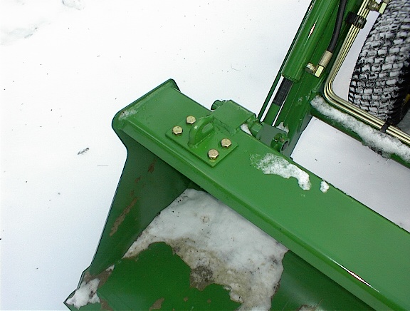

I also live in Hillsboro county. I don't own a welder or means of getting my tractor to the local welding shop.
I bought some weld-on style grab hooks from AW Direct:
http://www.awdirect.com/awdirect/finditem.cfm?itemid=7299
They must have a local warehouse because I received the hooks in one day! The only downside is $5 minimum shipping charge, total was $12. I prefer this style hook to the one you found in Northern Tool because it will "grab" a chain anywhere along its length without slipping.
BJ's Welding in Milford cut four 5" long pieces out of 3" wide x 1/4" thick flat steel. They welded the hooks to two of the plates, charged $30. Since I had this done only six days ago, I'm sure they have plenty of material left.
I took the parts home and drilled all the holes, cleaned and painted everything, and bolted them on. The backing plates are underneath. I used bolts with "yellow" plating to match the rest of the hardware on the tractor. They look like they came from the factory. A picture is attached.
Since the top of your BX bucket is somewhat different than my 2210 (rolled up front lip and centrally mounted cylinder), your mounting plate might be different.

CBH30,
They look really nice. I wished I could do that on my rig. My bucket is of a little bit different style so I really don't know how I am going to get a hook on mine. I was thinking I may have to have something welded right to a plate and have the plate welded to the bucket with a support underneath.

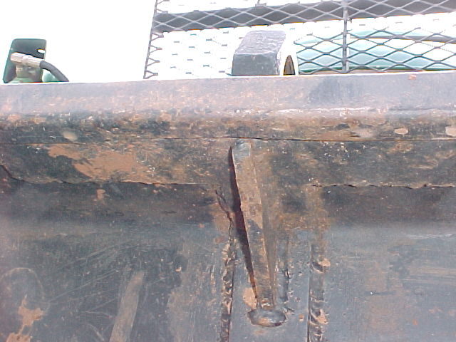

Either welded or bolted would probably work well. cbh30 did a great looking job with bolting his hooks. The "hook" on my loader is an old junkyard nut. It's welded, top center. The first time I used it, the top began to buckle. Since I reinforced the area with some flat bar, it's holding up much better. I like having the "hook" in the middle of the bucket, but the bucket top is more prone to buckle with the hook at that location. So, a little extra reinforcement is worth considering.
Someone (in another thread) mentioned welding a length of round stock at the front lip of the bucket top. That would also help strenghen things. I have a piece cut to size and ready to weld, but will wait for a little warmer weather.
Pictured is the reinforcement I added. I am satisfied with the improvement. I plan to add the round stock as a little insurance.
