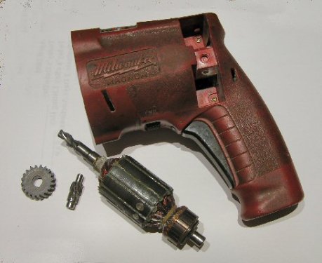

Frank my Milwaukee drill is at my feet in pieces. Stripped several gears and found out today they are now obsolete. /forums/images/graemlins/frown.gif
I'm thinking of buying another new Milwaukee, since it was such a good tool. /forums/images/graemlins/grin.gif

Mike you cant get parts for the hole shooter anymore ??? That sucks, I have two of those one with the metal keyless that I know I can not get anymore.....
/ bucket hook pics #16
My Milwaukee Magnum must be 30 years old and stll strong. /forums/images/graemlins/grin.gif It sure makes me sad to see Milwaukee put all effort into cordless tools that last much less /forums/images/graemlins/mad.gif and have $70 batteries instead of really durable tools.
