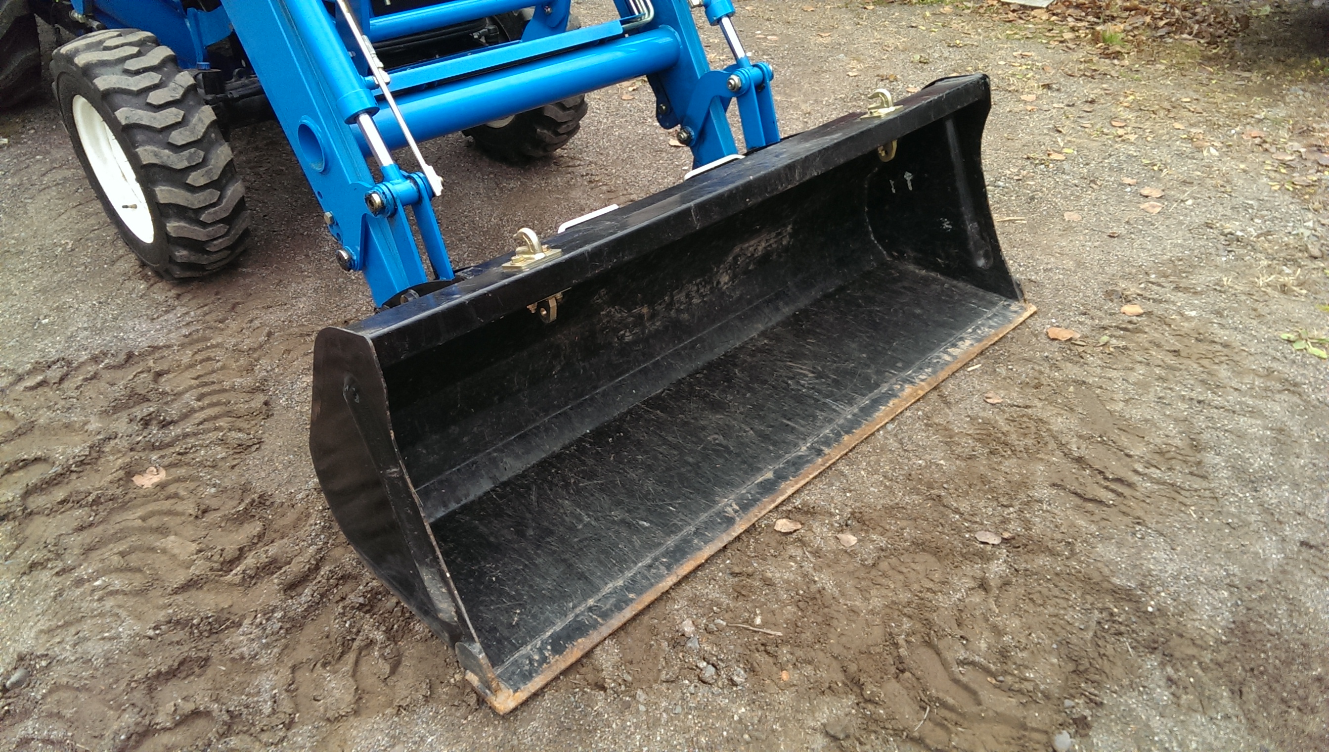

We will be finally picking up the XR4145HC this Saturday. I am looking for photos or ideas of how bucket hooks were done. I am reading and looking to see who has bolted them and Who has welded them if anyone actually has.

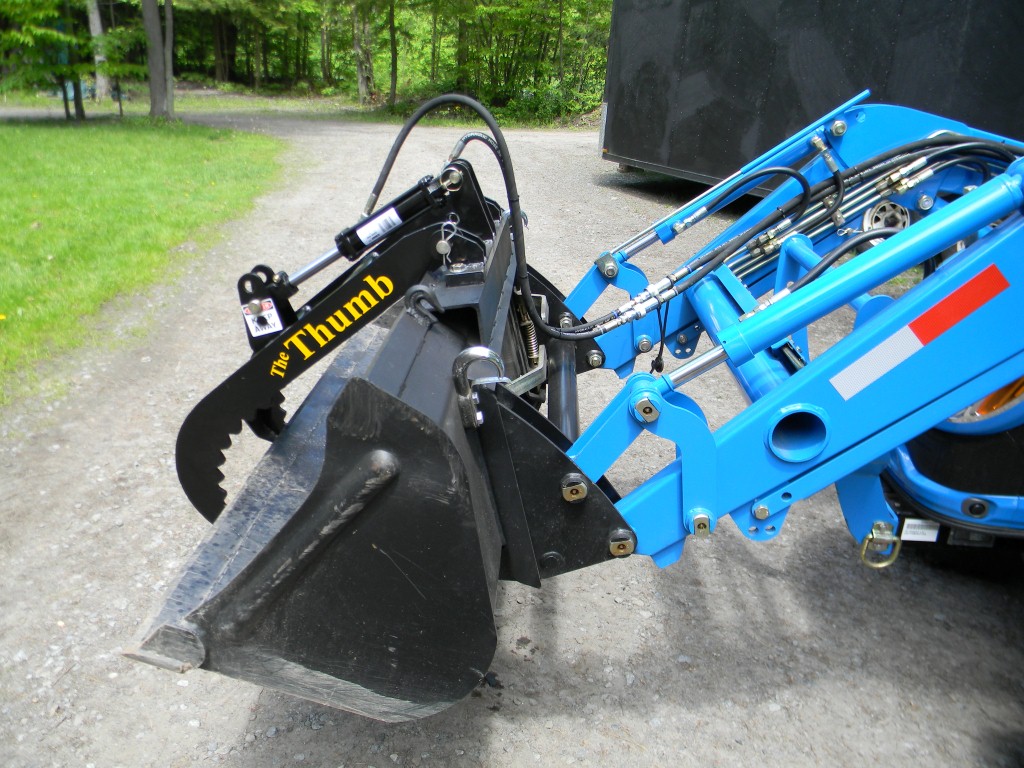

Kens bolt on hooks on the outside and clevis/shackle backer plates on the inside of a 66" bucket .
Good quality hardware and a good guy to deal with .
Thanks! Can I steel that pic for the website?
What tractor/loader model number is that?
   / Bucket Hooks on NEW XR4145HC #10
Steal away sir . It's a 2014 LS G3033H with an LL3102 loader and a 66" bucket .
