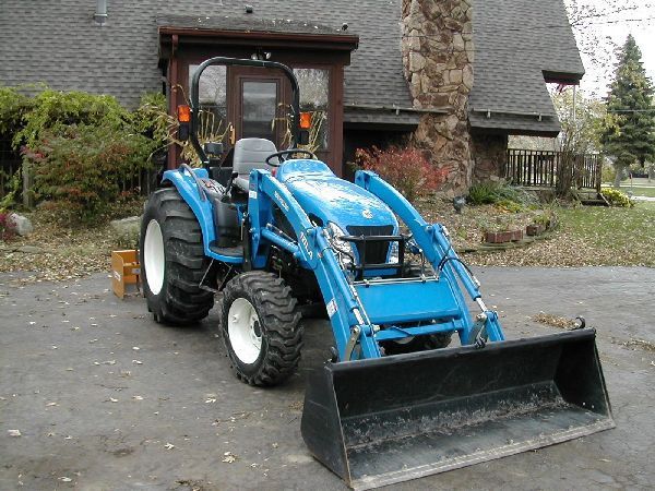

tc33Brad; Bucket hooks? We got plenty of bucket hooks. I welded on a grabhook in the center, and bolted on jeep recovery hooks on the ends. I'll post the best photo to give you an idea. Sounds like you have the bucket on my 16LA. /forums/images/graemlins/grin.gif
Guess it's a little hard to see, but maybe it'll help you out. /forums/images/graemlins/blush.gif

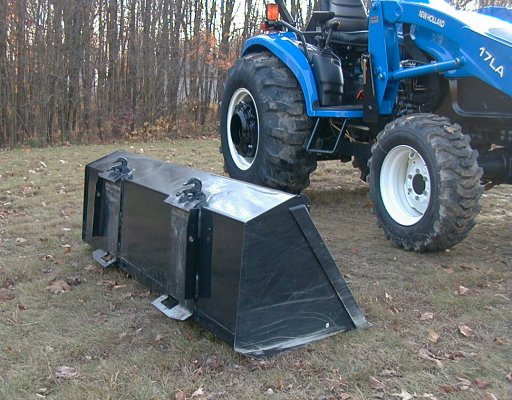

I'm not a believer in bucket hooks welded in the middle as I have seen too much damage done to buckets at their weakest point. However you can see from our picture how we added two hooks on a reinforced portion of the bucket.
