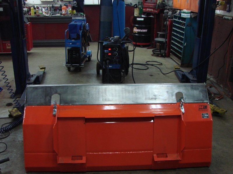

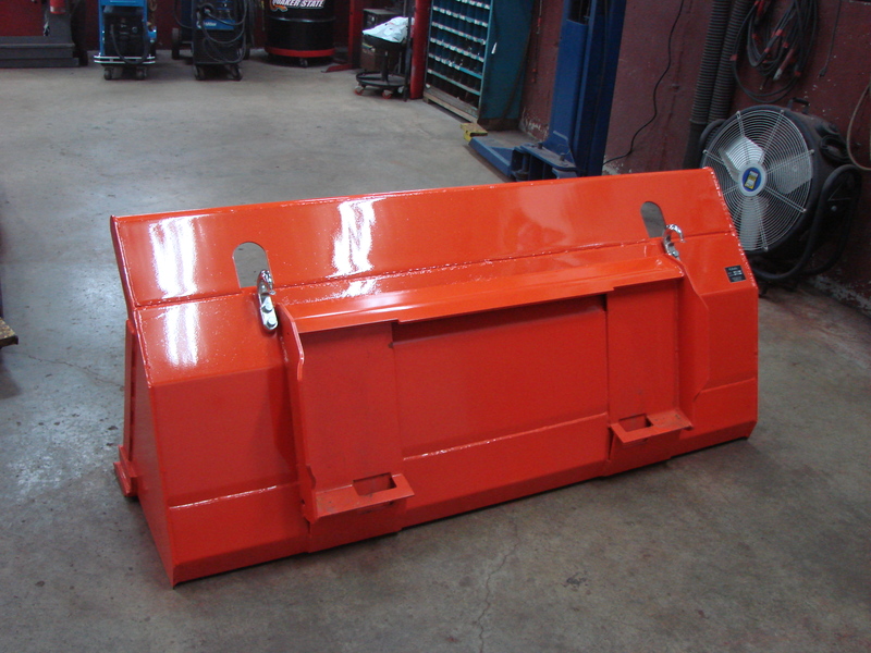

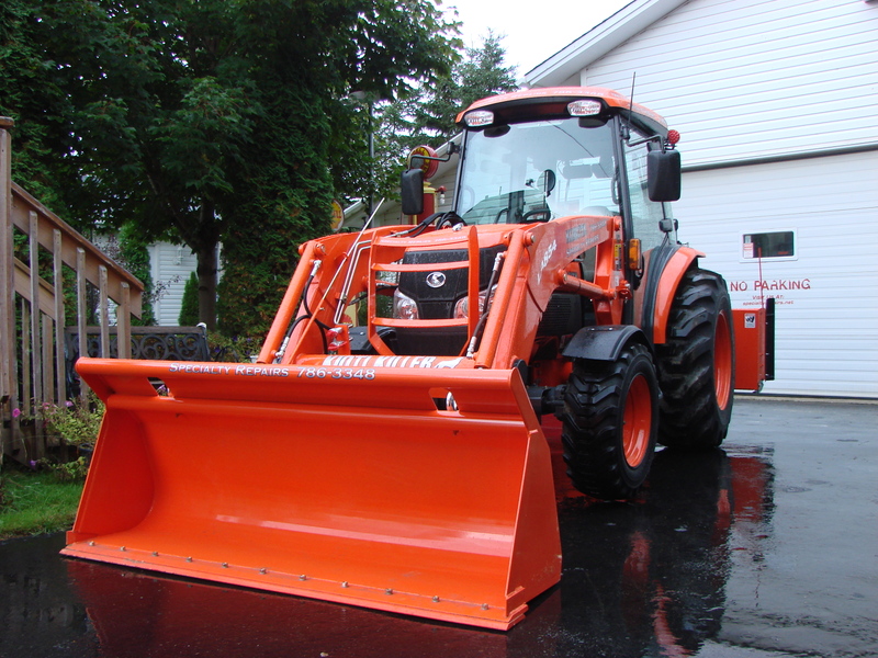

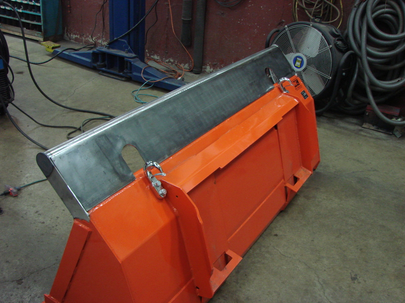

I can't say that I modified mine to handle more material but I did it more for safety. Now when my bucket is right up I don't have to worry so much about snow falling on my hood but it still is classed as a "Modification" .
Dang 4shorts,
You do nice work! If I were to do something that nice it would take me 2 weeks and about 3 "do overs"!
Carry on,
Phill
