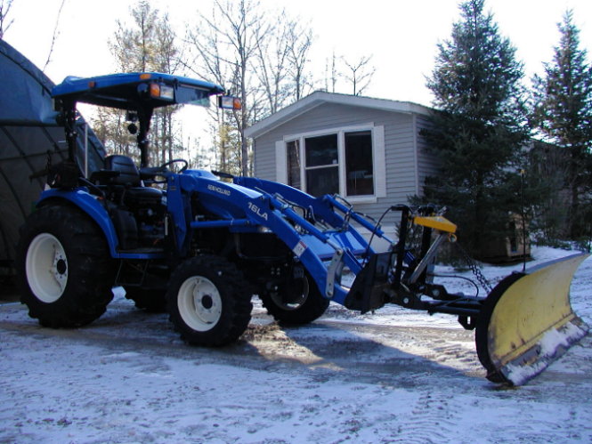

Find yourself an old pickup snow plow, brand isn't really al that important. Mine happens to be a "Fisher", and adapt it to work with your tractor. There have been many differant ways that people have attached theirs. I had mine adapted with a plate / bracket for use with my quick hitch.
I have Maybe, $500 invested in mine total with the purchase of the old plow, bracket, hydraulic lines and welding.
There was no way that I could get a new plow set up or even a snowblower for I will guesstimate $2000 at the minimum.

You'll spend $1,700 - $2,100 for a Curtis blade similar to a truck blade that installs on the bucket mount pins on your FEL. Exact price depends on whether you want power angle and the size of the blade.
http://www.curtiscab.com/tractor_loader.html
attached is what I plan to use this winter, but it's only for light snows, as I have a 60" blower on the rear:
