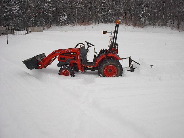

I'm using my FEL and a Back Blade. Works out good for me. When the snow is real deep, the wife takes the snowblower and blows the pile(s) as I stack up the snow. I see no need for a front mounted blade. Gerard

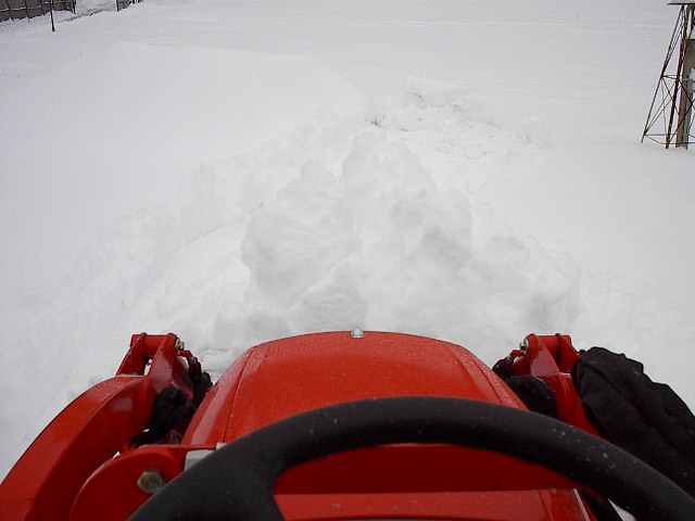

And when I do use the FEL, it works just like a blade but is much easier to stack out of the way. Gerard
