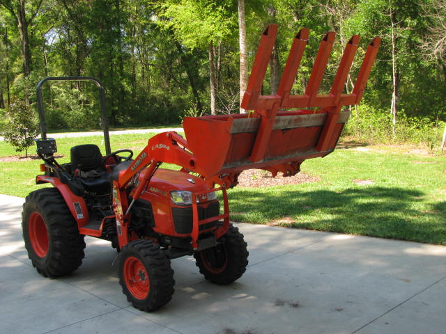

Drawback with STEEL Debris Forks is their weight, which is cantilevered out in front of your bucket, so lifting capacity decreases pretty quickly. Also, mounting and dismounting heavy steel forks to the bucket can be hard on your back.
ALUMINUM Debris Forks are half the weight of steel but are considerably more costly. I have been using Payne's ALUMINUM Debris Forks regularly for three years plus. I routinely pick up 1,200 pound tree trunks without straining the attachment. Very strong DFs!

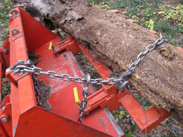

Steel or Aluminum you will want 5/16" Chain Grab Hooks on your bucket to stabilize heavy loads. A load shift can roll a tractor on uneven ground easily. I bought bucket hooks from Ken's Bolt On Hooks in Maryland, a well regarded, helpful vender on T-B-N.

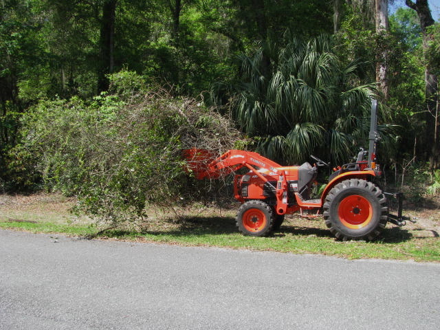

Tractor in photos 1-2-3 is a Kubota B3300SU. Now I use same forks on Kubota L3560, photos 4-5. Photo 2 under bucket support.
LINK: Ken's Bolt on Grab Hooks <<Home>>
