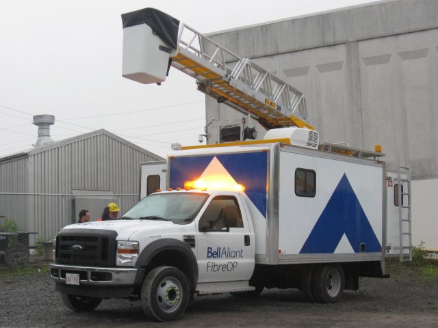

Many years ago I spent a fair amount of time in bucket lifts at 40-foot elevation running data cable. I am nether afraid of heights or overly cautious but the lift shown in these pictures makes me nervous just looking at it. The saying "give me a long enough lever and I will move the world applies," soft ground or too many fries for lunch and that puppy is going over. Home Depot in my area rents trailer mounted buckets, maybe try one out to see if it meets your expectations plus it would give you some time to determine what commercial lifts use for hydraulics and how they stabilize the base.
   / Bucket truck boom mounted on trailer #8
Nice buy 307, it's a really good lift, they only take 3 to 4 GPM to run at 2250 psi, but PLEASE trust me, DO NOT MOUNT IT ON THE TRAILER...... i build and maintain these for a living, those little hand crank jacks will fold up like a wet noodle when you extend out to the side, i sent this pic of one from HR Aerial that has a 36 ft reach, the truck has 1150LBS of counter weight mounted between the cab and rear wheels to stabilize it, PLUS the weight of the truck and box... it tops out at about 14300 lbs total.
If we install one with outriggers we use 4 inch x 2 inch rod cylinders with holding valves on the cylinder and these are welded to 2x8 1/4 wall steel tubing, this needs to be engineered, yes it can be done but it will not be cheap.
Jim
