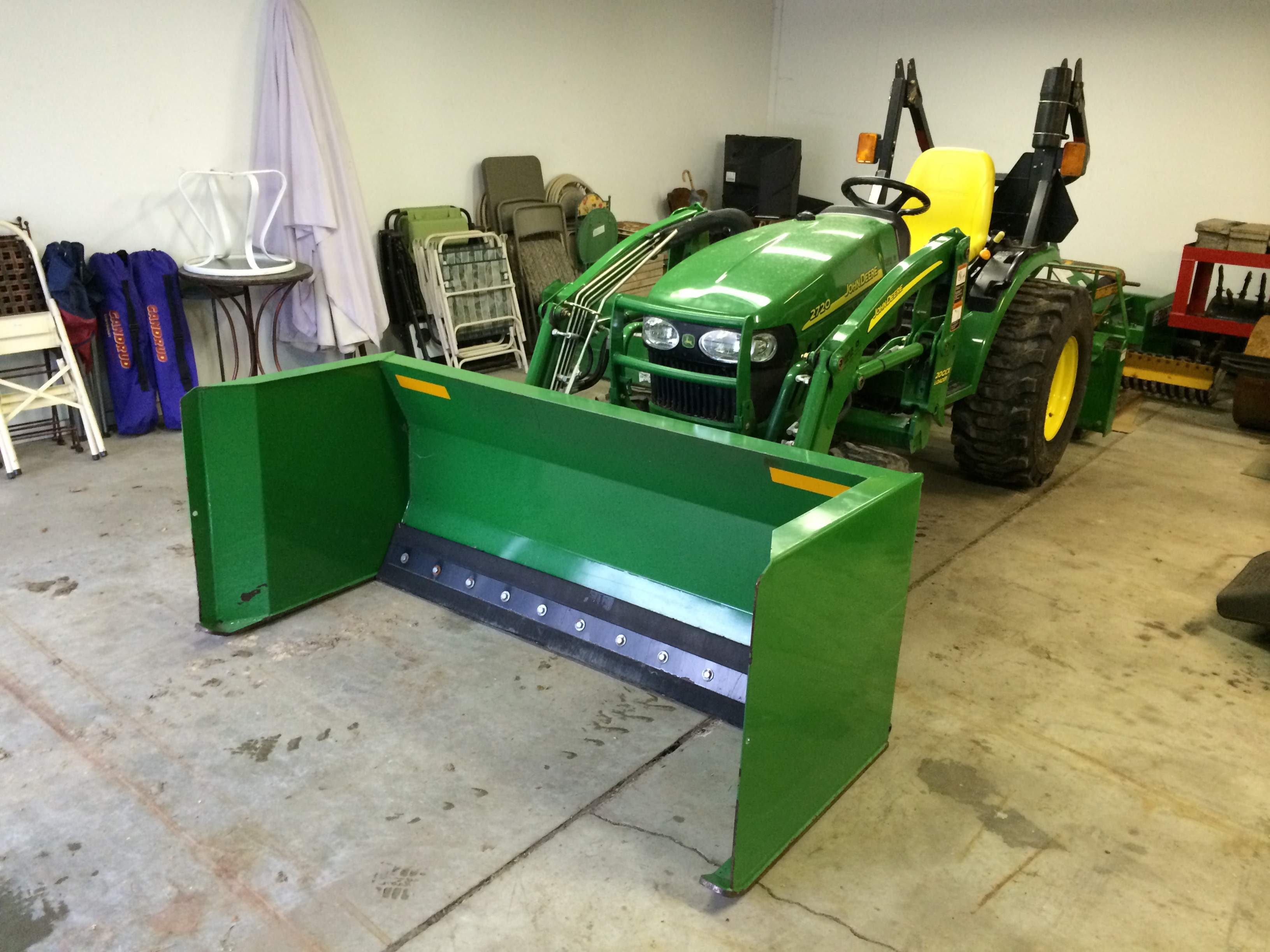

Anyone have any pros or cons of using either a bucket or snow pusher? THanks
   / Bucket vs. Snow Pusher #2
Buckets tend to be narrower than the wheel track and that poses problems.
Snow packs up in bucket and emptying a pain.
With a pusher you can work wider and push off to the side, angle pusher curls snow to the side neatly and is fast. If you need to pile/stack snow with pusher you simply lift gently all while pushing ahead

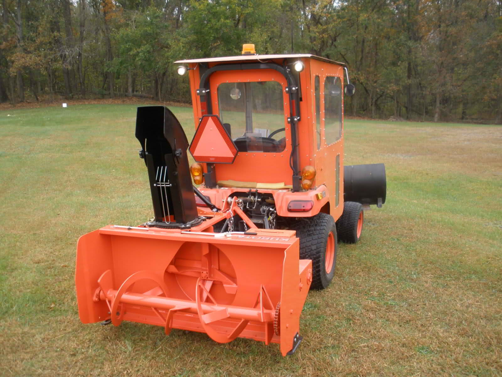

My 2 cents, pusher for lighter events combined with rear blower to really get rid of the white stuff.
Pusher only will result in higher piles as winter progresses which in turn makes for deeper and deeper snow drifts.

I am ordering a 8ft HLA pusher that i can back drag with. I should be able to clear my garage doors easier, plus other areas. Buckets ok but this will work better for me.

I had a pusher on the Gravely and have an FEL and back blade on the 4wd JDs. I liked the pusher on the Gravely but wonder how it would have been in our "snowmageddon" about 4 years ago. Best thing for that would have been the old square chute snow blower on the Gravely. Would have taken the snow and slung it way out of the way.
