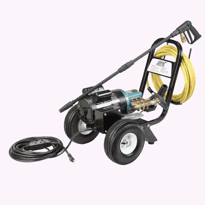

<A target="_blank" HREF=http://www.northerntool.com/cgi-bin/ncommerce3/ProductDisplay?prrfnbr=382417&prmenbr=6970>Northern Tool Electric Pressure Washer</A>
This unit is ~50% more than a similiar output/pressure unit with a Honda gas motor on sale at Home Depot this week for $399.
Home Depot Honda Powered Pressure Washer
2400 PSI 5 HP 2.5 GPM Gas Pressure Washer
Model: #EXHA2425
SKU: #819683
$399, with no shipping charges.
