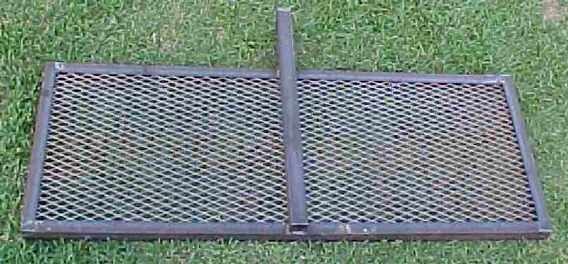

I have seen pictures of these in catalogs. Built my own. It fits my truck, my tractor 3pt receiver hitch, and also my tractor front bumper. (next post) The receiver in my front bumper has been great. A place to pull from, add a weight rack, a spray boom, lots of other ideas to come. My little ATV sprayer should fit well, so I can spray the fence while I mow. This box removes in seconds.
I used this box this week end to carry posts, two chain saws, fuel, chains, axes, etc. Worked great! It even pushed over a small tree. I'll add removeable hand rails (manbox) and some straps on the bottom so It can be picked up with my forks. Then it will also be a personnel box for the front end loader.
34" of 2x2 x 1/4" tubing, (2) 2" x 3" x 24" 1/8 angle, (2) 2" x 3" x 60" 1/8 angle, 2' x 5' heavy expanded metal. I'll get it hot dip galvanized next time I take stuff for galvanizing.
Hope this helps someone.

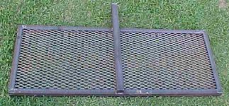

The underside of the box. Very simple.
