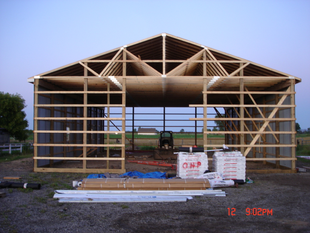

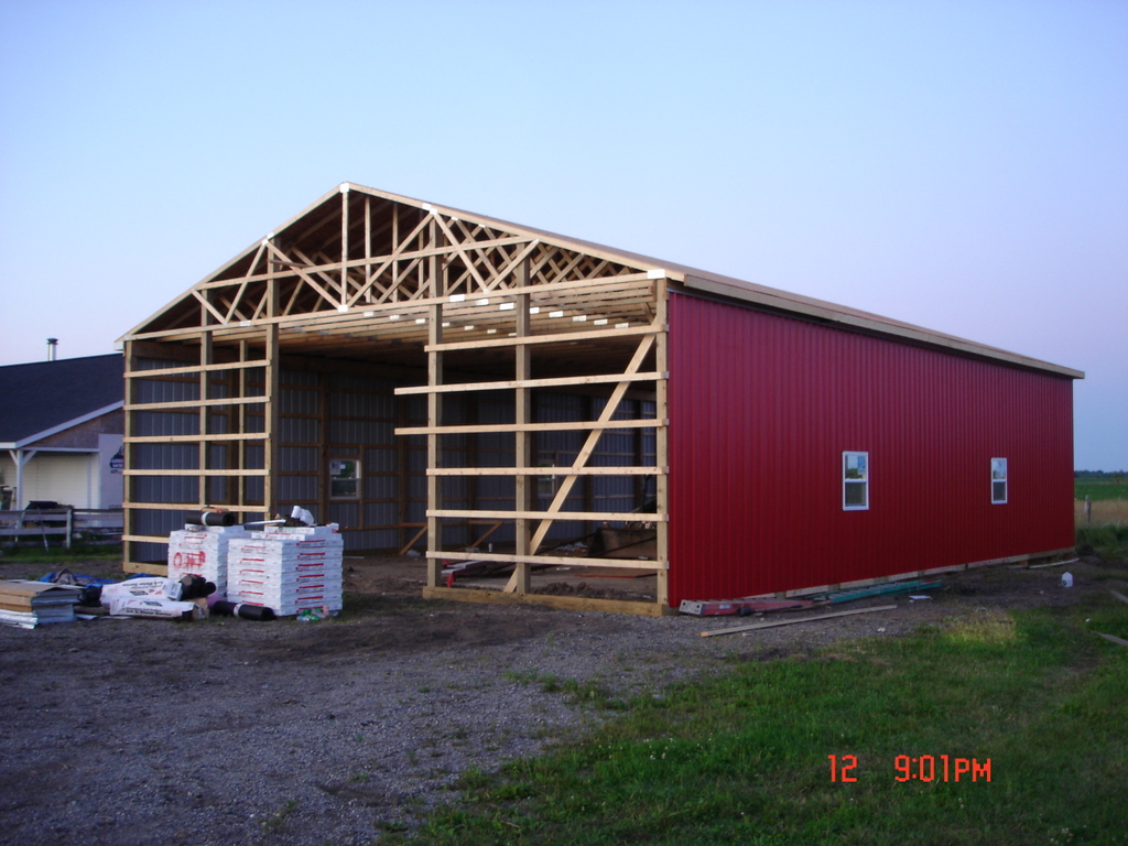

My barn was built with nothing but ladders and went up very quickly it is 40 x 60 x 14 and has 31 trusses set on 24 inch centers that were placed in less than 2 hours using only a bobcat with an extension cobbled onto the front bucket.:cool:
Once the poles are set the wall purlins are nailed in place they function as a giant ladder to access the top of the wall for setting the trusses:D
After that they function as a ladder to nail on the siding, only the last one on a wall section needs to be accessed with a ladder. One man stays on the wall and another passes up the siding and you work your way down the length of the wall with the man on the ground humping siding and nailing as much as he can, when you get to the end of the wall the man comes down and helps finish nailing the bottom of the sheets that the man on the ground did not have time to nail because he was busy handling and holding siding in place:D:D:D The wall goes up very quickly without the use of a ladder.
It goes even faster with screwed siding.:D:D
You can see the bucket/truss setting boom pole in the pictures. :cool::cool:

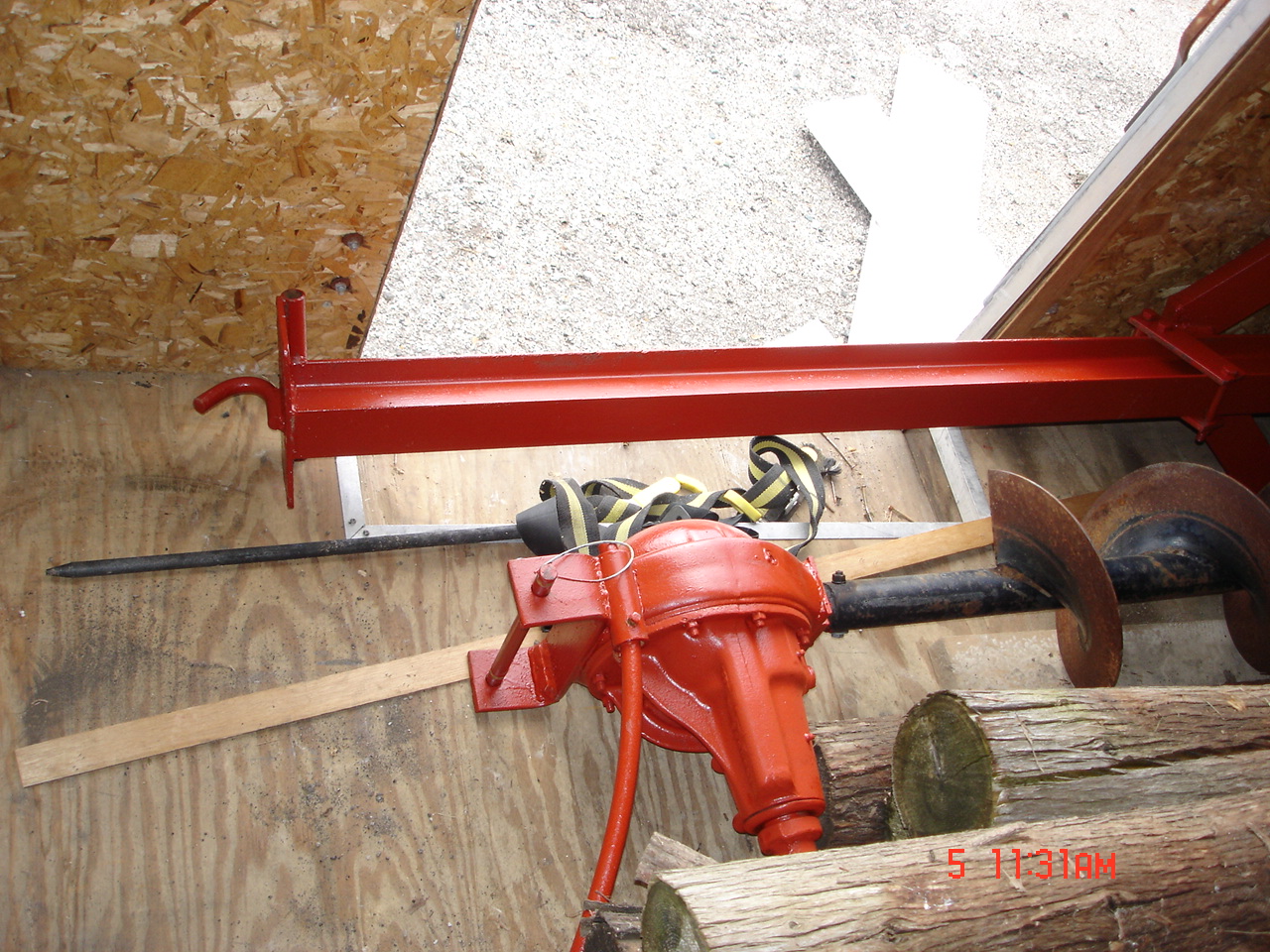

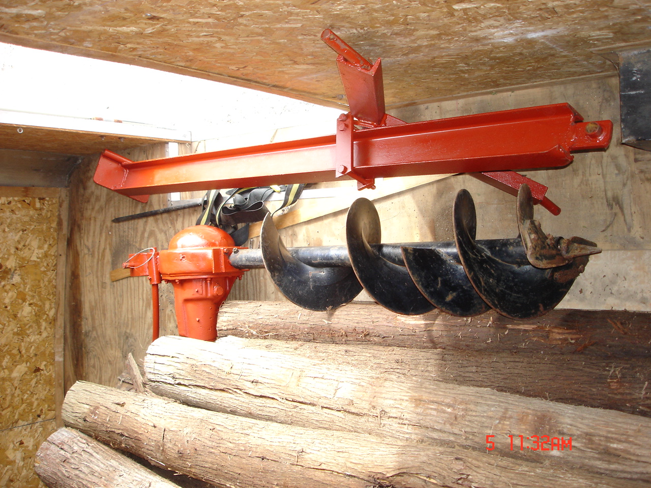

I did the same thing when I built my last barn. I used my Jinma 254 and the I-beam pole for my PHD like yours. I cut a piece of plywood to fit in my bucket and then screwed wood blocks to it to hold the beam. 4 big ratchet straps pulling from all 4 corners held it tougt. Gave me a good 20' of lift. A crew of 4 of use set the trusses in a few hours.
Wish I had a picture.
Here are pictures of yours. I put the piece of the I-beam that goes in the top link on the plywood and used wood blocking with a bolt though the hole. I used the J-hook end to lift he trusses.
Chris
