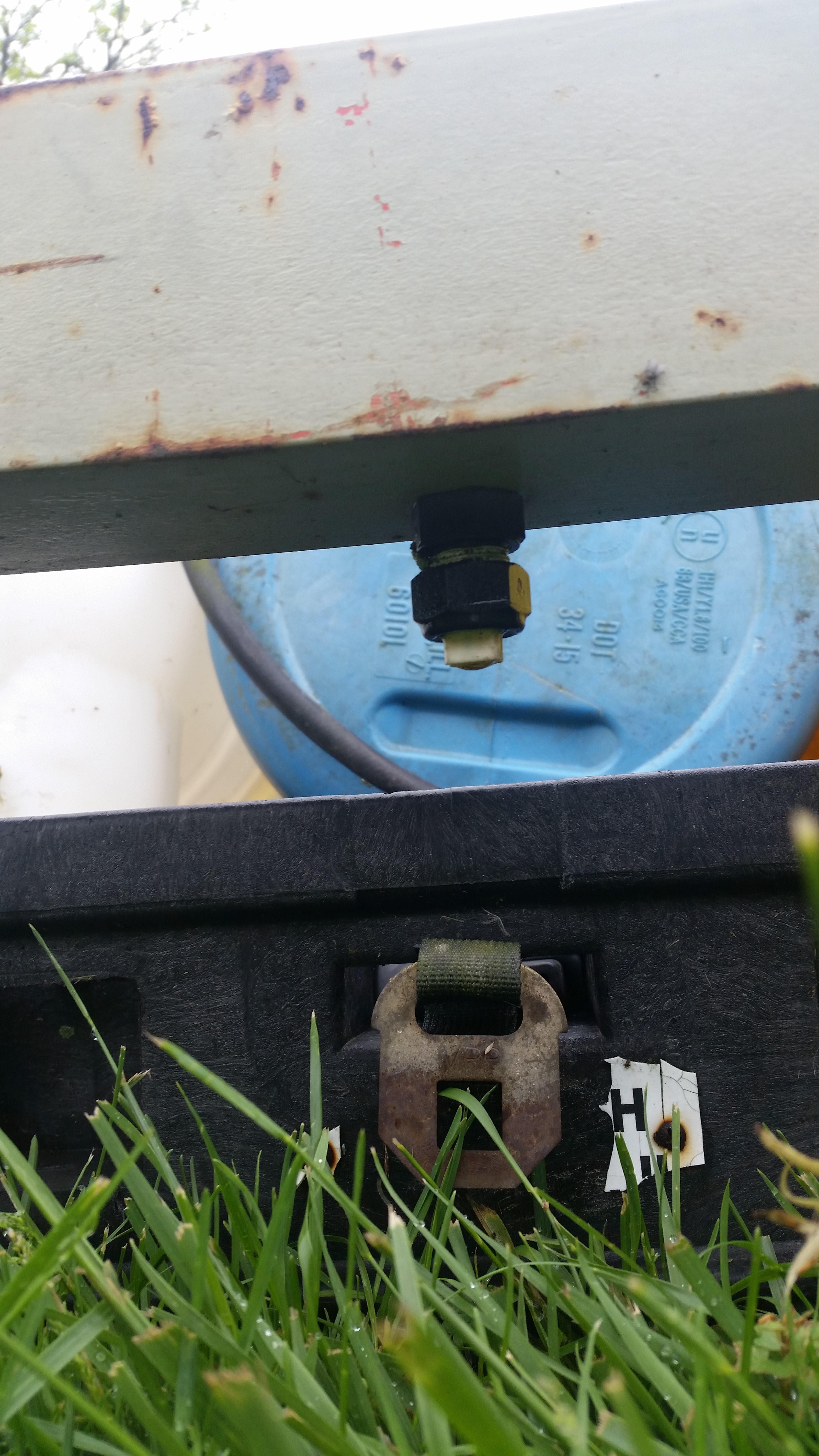

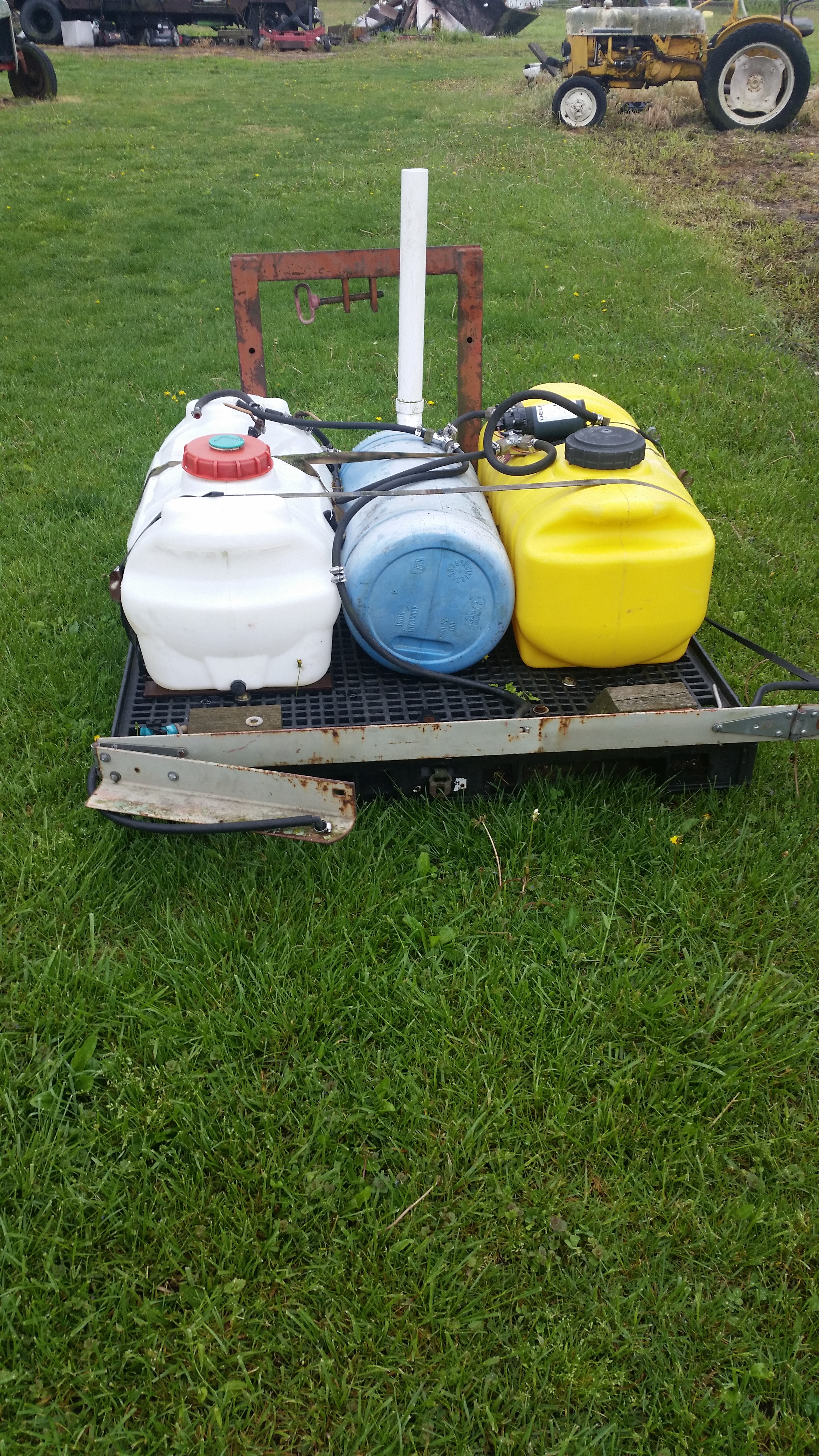

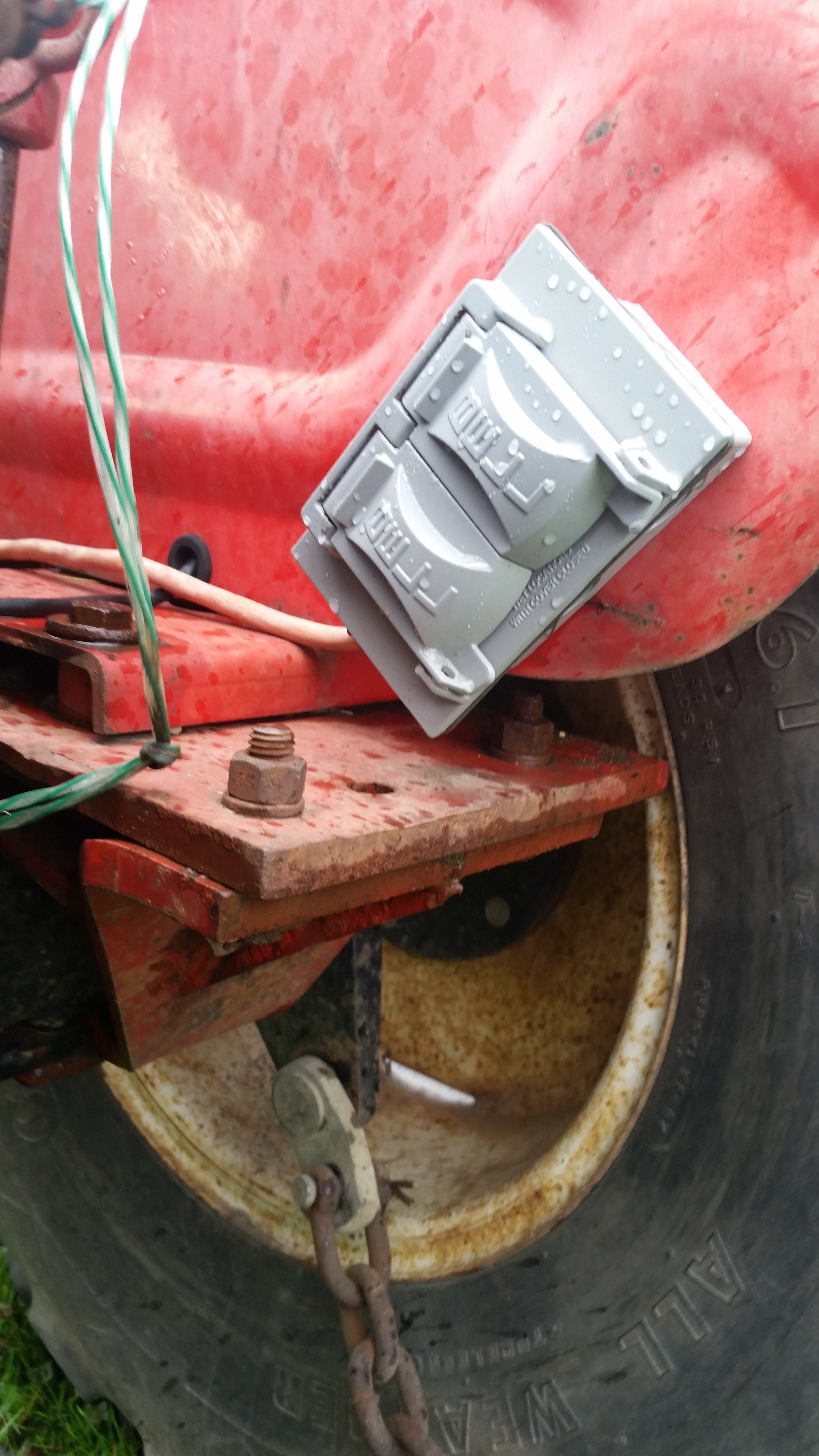

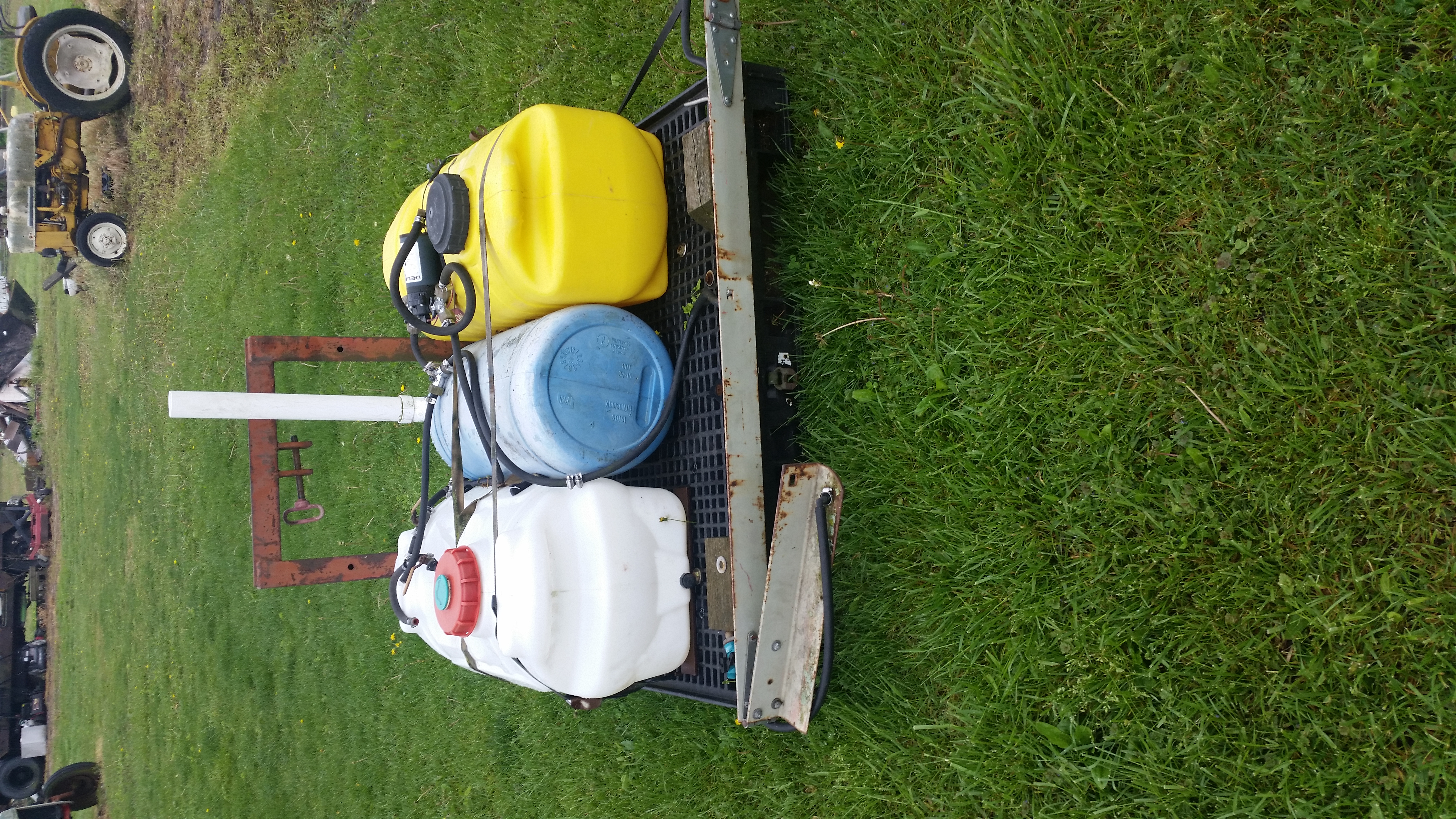

Here is My Spray Rig, they are 25 gal, 12v pump, mounted on a plastic pallet. It is attached to a cheap carryall that I had, so just hook and spray. The blue barrel is Soapy Rinse Water. Dandelions are Yellow, so I put my "good Bye Juice" in the Yellow sprayer and use the white tank for "Bug Off Juice", for my fruit trees and garden.
Ok, so I put a 120 electrical plug on the 12v wiring, I plug it into the covered 120 box on the fender. I turn the sprayer on and off with the switch box under the dash, which is wired to the battery, works great.
You can see the Gated Garden Wye's mounted on the pump, one on intake and outlet. Open the line to the dandelion tank and it sprays "No Grow Juice" thru the 6' folding boom or thru a hand wand or both. It is set up so I could spray both Herbicide or Pesticide at the same time. Then when I'm done spraying, I close the gate to the poison tanks and open the line to the Blue Tank and spray Soapy Water to clean the system out.
The only problem I have is with the 12v pumps drawing moisture and rusting and locking up. Then I have to take them apart and clean the insides and keep going till they just refuse to work, then buy a new pump. As a Farm Fertilizer truck driver, I Know how Hard these chemicals are on stuff.
The boom is a piece of 3" angle iron with holes drilled for the nozzles, it has 5 nozzles all together. A bungee cord holds the boom extension open and folded up. I bought all the parts at my local farm store, T.S.C.
sprayer plug in.jpgsprayer system.jpgSprayer shut off.jpgsprayer boom.jpgsprayer boom 2.jpgsprayer tanks.jpgsprayer nozzle.jpg
Hope you can get some ideas out of this and anybody else that needs a good Spraying Rig....
