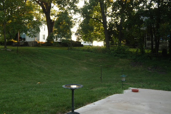

Ok for all the wizards of building a large project here is one.
I am going to build a 34ft wide by 30ft deep detached garage in my back yard this late summer or early fall. There are a few problems I need some help with first.
1. The 1st picture shows the location I want the garage. I am pictured there for scale and I am sure you will (at a glance see my worry). I will have to place the garage into the bank in back and on the right. I am thinking it is going to have to be at least 8 ft wall in back and 8 on the right steeping down to 4 ft.

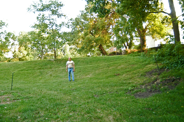

2. The 2nd picture is taken from what will be the back of the garage looking to the
Street and where the new drive will have to be.

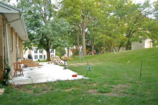

3. The 3rd picture shows the back of the house and where the side door would empty to by the back door and patio. We are doing this project for two reasons 1. I need the space for tractor and 2nd car. 2. In years to come we can park in back and not have so many steep into the house, the front has over 17 steps.

1. Is my location feasible? Meaning placing into the hill.

Roger,
I'm not a builder, but I don't see a problem. In my area, they build houses with what are called "walk-out" basements and they build them excatly as you are describing. On a lot with a slope, they excavate into the hill, dig and pour the footers and then form up the basement walls. In fact, they did excatly that with my home. The height of each wall is dictated by the slope. and one or two walls are entirely framed. The only caveat is that you waterproof the walls that will be below grade and place sufficient gravel and drain pipes in before you backfill.

ID cut the hill back and pour the back walls out of concreet (at least up to grade) to double as retaining walls.

It looks like you have some pretty mature trees in that tree line along the right side of your lot. I'd be concerned that cutting into the hill as much as you need to would cut some major roots and endanger one or more of the bigger trees. You might want to talk to your county arborist about that just to be sure.
Also, if the tree line is your property line, you might want to double-check your setback requirements. Your rope outline looks to be about 5 feet and, in my experience, setbacks in residential areas have usually been 10 feet minimum for side lot lines. (Except when I lived in Southern California where you could almost hand a roll of toilet paper from one house to another. ;) )

thanks folks for the advise. Here in Hannibal MO. the set back is 25 from the crub for the front, and 5ft on the sides and back unless in new sub. In those case it can be more.
The trees are on the next door neighbor, but I took the picture with a wide angle lenns. they are about 15 ft from my walls and some are more. So the largest tree within 15 ft is not more than 8 to 15 inch wide then there is a 100 year old walnut that is oh about 40 ft away. what do you think would they be in dager.

Mornin Rojer,
I dont think you would have a problem at those distances ! The picture was a little bit deceptive.
