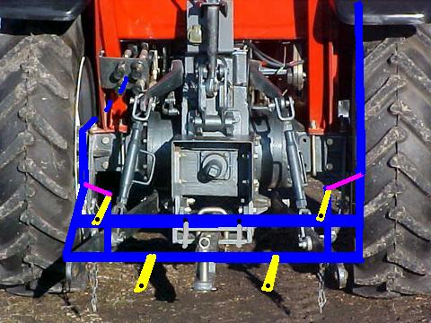

Picking up steel today ($300) should have some extra. In the picture (not to scale nor very good) the blue color is 2x4x1/4 box steel. My back wheels have been set out so there is room between tires and tractor. 2 pcs go to the FEL bracket with pins or bolts. Another going across and bolted to the drawbar bracket. The next pc back will be for attachment to the existing lower links (on the backhoe). On my backhoe, besides the 2 lower and top link, there are 2 upper attachments right above the lower ones. So the plan is, to have the subframe mounted, and then attach backhoe with these 4 pins.
The long main beams will sit right up under the rear axle (square axle at this point) and have a sorta U shape going over them made from the same box steel.
I will try and take pictures from start to finish.
<font color="red"> Is this overkill, or is there such a thing? </font>

I started the project last night with the brackets that will connect the subframe to the FEL mount. Since I will have several pictures that are large, please click HERE to see the progress pictures. /forums/images/graemlins/grin.gif

Well, welded up a few more pcs to the puzzle, sure would be nice to have a picture of the finished puzzle. The link is Here for project pictures.
/forums/images/graemlins/frown.gif Kinda disappointed the thread did not generate the input I thought it would, maybe some thoughts on design, or welding is what I envisioned this might inspire from the fabricators out there.

Thanks rebel300r, it has been quite a project, especially with the 98 degree temps and humidity. I pretty much have it done, no paint yet. I tried every way I could to keep the mount on the tractor with backhoe detached, but couldn't figure out how to make it strong enough and still have the 3 point arms to move down far enough. But, I can now lift the back end off the ground and not feel like it will break, or break off the top link mount while driving down the road. Overall, I am pleased with the results. Posting more pictures tonight. I did use 2 top link adjustable rods as part of the hookup, that way I can tilt the backhoe forward or backward if needbe. And the backhoe has no welding on it, just hooks up in 4 places.
It's well worth the effort. /forums/images/graemlins/grin.gif
