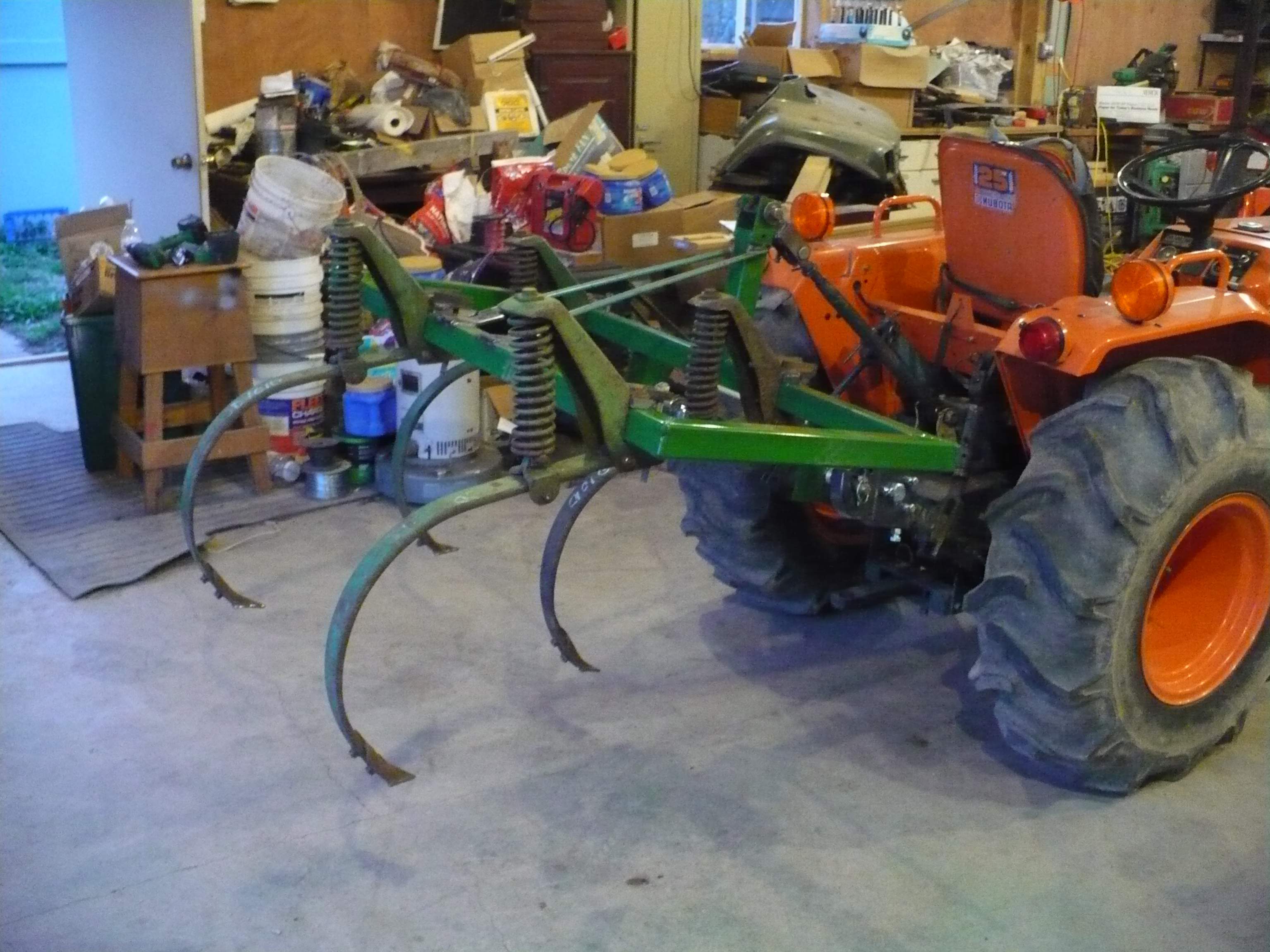

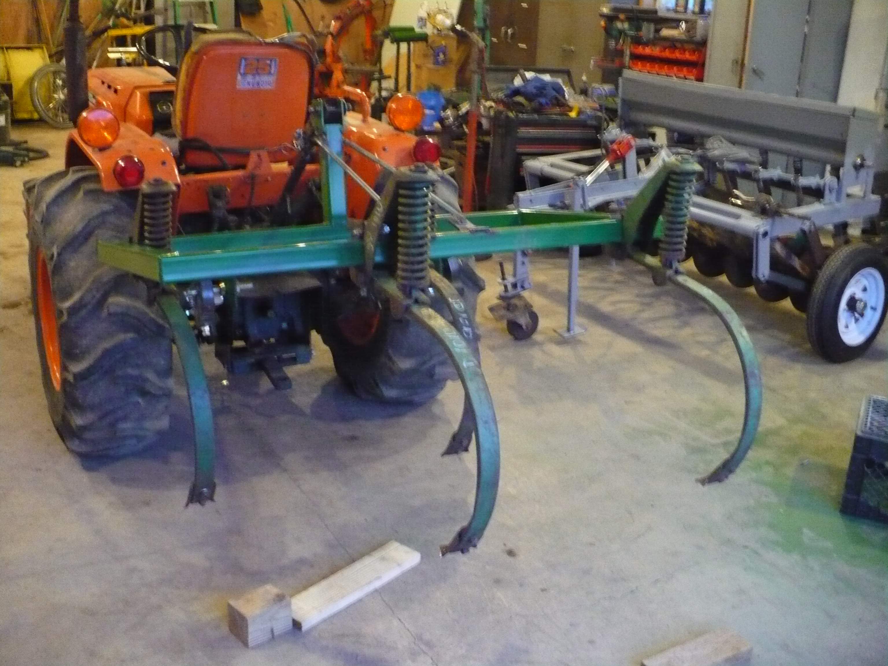

Just putting the finishing touches on a 4 shank chisel plow for my B8200. I used John Deere 1010 field cultivator shanks I got at a farm equipment salvage yard. They had duck foot sweeps on them, so I cut them down to chisel width. Hopefully, I'll get to try it out tomorrow or Monday. I'll finish the paint after I make any final adjustments. Sorry about the messy shop!

Looks nice - my favorite kind of plow. I have one with sweeps (shovels) and one with chisel points. This year I got the fields ready to plant without even hooking up the tandem disc. They make chisel points that will bolt on for around $10-15 each.
It will be interesting to see how the bota does. Running shallow you should be ok but going deep it may be more than the tractor will want. I have a ten foot wide 11 shank chisel and it will stop my tractor dead in its tracks if I get too deep and my tractor has 130hp, duals, and weighs close to 15,000lb (it is the tractor and plow in my avatar).

bdog, I got it in the ground yesterday in one of the gardens. I was able to pull it about 4 1/2 inches deep(4WD low range, couldn't move it in 2WD). The soil is nice and mellow, lots of organic matter. I was hoping to get closer to 6 inches, but this will have to do. The rototiller doesn't go much deeper, anyway. With the weights, chisel and driver, the outfit comes in right around 2000 or so pounds. My whole idea was to do some primary tillage to make things easier on the tiller, and I got that. I was pleasantly surprised at the tractor. For being rated at 19HP, it pulled it nicely. I was really cautious about building this. When we farmed, I pulled an 11-point Case/IH Hi-clearance chisel at 8 inches with a 2-105 White. I didn't like the beating the tiller took in untouched ground. It ran easy and quiet after the chisel. I tried moldboarding ahead of the tiller last year, but my wife actually suggested the chisel after she twisted an ankle in an open furrow, and our 1 1/2 yr. old granddaughter fell face first into the same furrow. I'm like you, I always did prefer chiseling.
