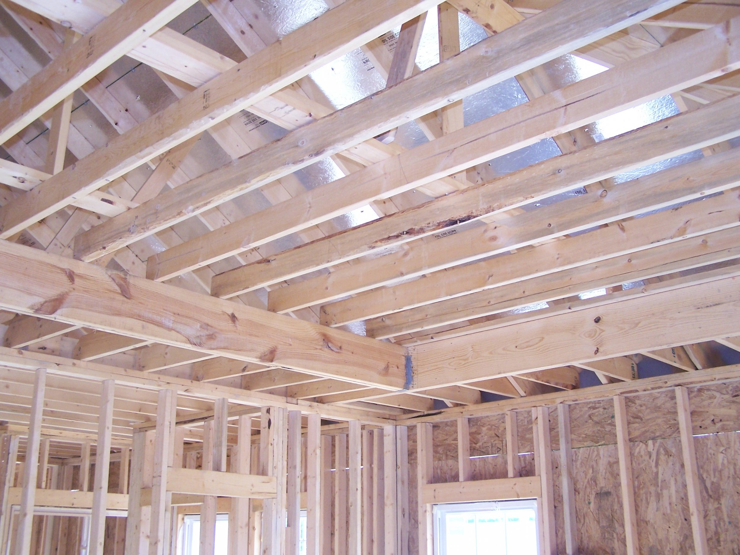

We have a comparable size all-electric home, 3200 square feet on 1 floor with a Trane 3.5 ton for the living areas and Trane 2.5 ton for the 3 bedrooms. They were installed in 2009 and are 14 SEER. The entry way which has 17' ceilings has ducts from both systems feeding it as it has a dormer and gets the west sun. We have auto season thermostats set from 68 - 72 degrees year-round. The house also feeds the barn which has a mini-split system in the tack room. Between the 2 buildings there are 4 refrigerators, 3 hot water heaters, and 2 laundry rooms. We have average billing which is running around $250/month on coop electric at $0.105/KWH.
I would go with the best system you can afford but also put your money into insulation. We also have R15 blown insulation in the walls, R44 blown in the attic, and double pane insulated windows. The deck sheeting on both the house and the barn is the reflective sheeting which prevents radiant heat coming into the attic, similar to LP Techshield as an example. Along with good ventilation the attic stays tolerable even in the summer, lessening the amount of heat radiating into the house.

Here is a picture showing the reflective deck boards. It is installed with the foil side down. If you zoom in you can see the instructions saying that.
