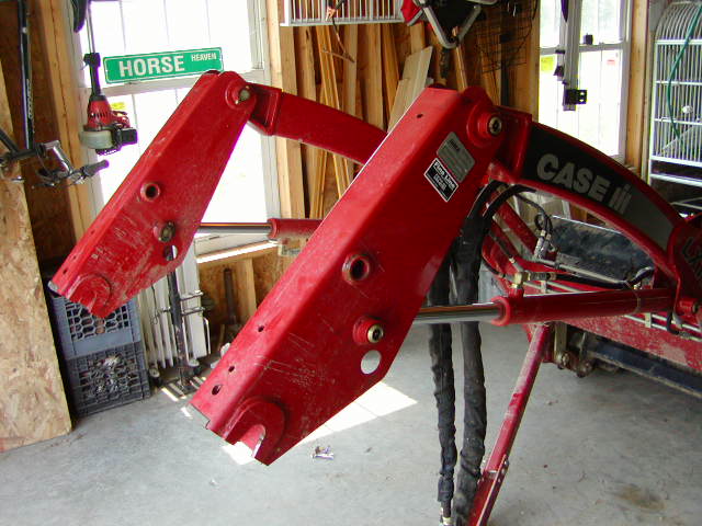

Looking @ the Pictures, it looks as if it has a leg under it to hold it in postition, and a Pin back @ the attachment point and it all comes off... It is a good design and looks similar to the attachment on My Case loader.
When you raise and loader does the Bucket move forward?
I really like the way it Tips so far back, and puts the load over the pins, that must increase lift capacity a bit. A little orange paint and it'll look better than factory. /forums/images/graemlins/smile.gif
I'll attach a pic of my facotry made loader off the tractor, it seems to be one of the better QA designs, and it takes me only 2 minutes to detach, and slightly more, 3-4, to attach.

Yep, it has an articulating bucket...it will maintain the bucket position throughout the lifting cycle. I just looked at a lot of bigger tractors and basically copied their design. I will say that it took a lot of effort on my part to come up with all the pivot points and linkages, etc. I also copied the Kubota method of attaching the loader to the tractor.....and the control valve stays with the tractor, kinda like the Green ones.
   / building a fel
that is a nice looking loader thanks for the pics. you designed it yourself im taking it. i like the quick detach. did you just base it off another loader? it looks like you used rectangular tubing for the arms. did you cut it out to taper it? i would like to see a few more detailed pictures of the loader attach and links if possible
