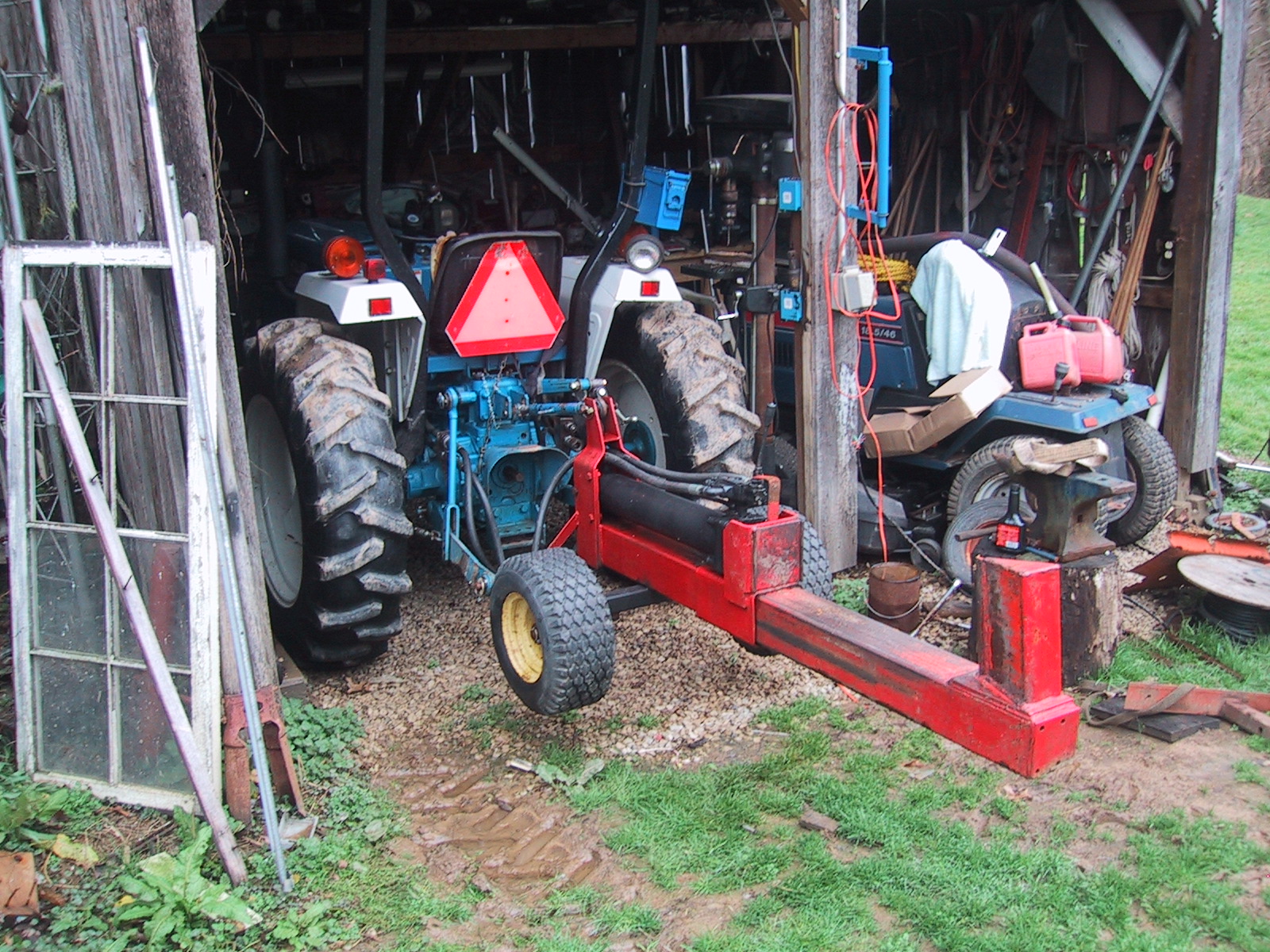

I built my own splitter a few years back. It runs off the tractors hydros. I pieced it together and have $425 plus 2 cases of beer in it.
It will go vertical also by pulling a pin and standing it up. I have since put on log catcher on the opposite side of the valve.
