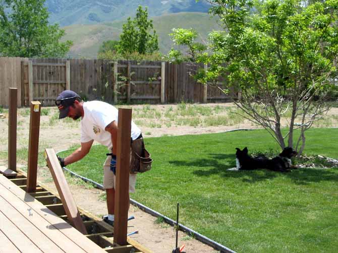

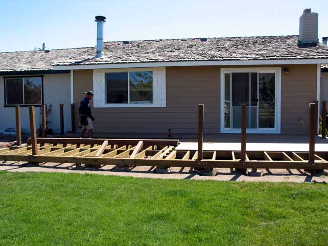

After getting all of the framing done it was time to temporarily set the posts. I had to add a little more framing for stability and used 2 7" carriage bolts to secure each of the posts.

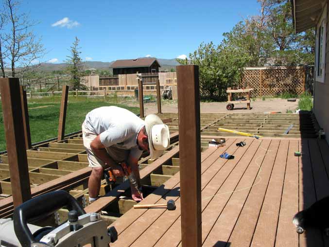

Attaching the boards proved to be a pain in the back, literally. I think I spend about four days in a bent over position. I did not want any screw holes in the material so I ended up using a product called EB-TY.
Basically they are biscuits with a screw that goes into the middle of them. Each board needed to have biscuit joints cut on both sides. After the board was set into place, a EB-TY connector was used on each floor joist. It is a very time consuming process, but the results are nothing short of outstanding.
/ Building a New Deck
#27
Still attaching boards... Since the deck boards are parallel to the home and the span was greater than 32 feet I decided to run a board running perpendicular to the home in the center rather than butting the boards together.

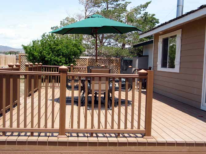

Finally the deck is complete! I can now stand upright (although I am still referred to as Link /forums/images/graemlins/shocked.gif).

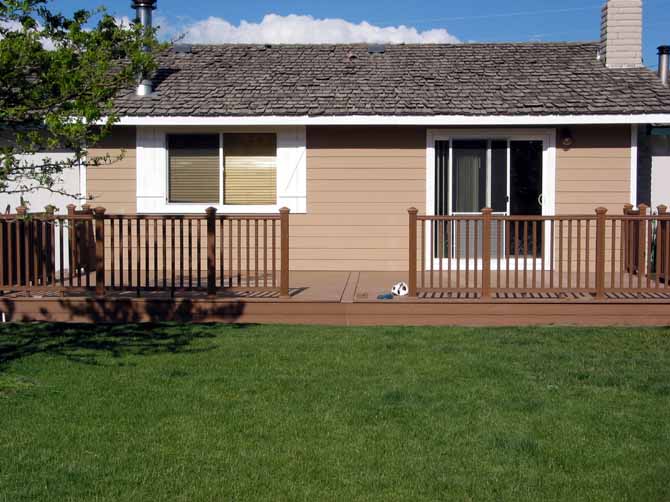

View from the side

Hey LINK /forums/images/graemlins/wink.gif, Deck turned out great ,good choice of colors and the center dividing board gets points for style /forums/images/graemlins/cool.gif
But I have a question about the backyard , the grass in the center is very nice but why is the perimeter all dirt? gocart or pony? /forums/images/graemlins/confused.gif
Oh BTW, That view is really something,but you already know that /forums/images/graemlins/grin.gif
