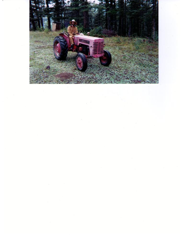

I spent several months searching, debating, pricing and talking to dealers regarding what tractor to buy for use on wooded mountain property (>9000 ft),
click here for thread
In the end I picked up a tractor in exchange for paying the gas and helping a friend haul an old 54 chevy up to the family farm in Preston Idaho. In exchange he gave me his old IH B275 (see attached).
I've currently been using it to haul cut wood, slash, etc. I'd like to skid logs but I'd really like to have a ROPS. Case-IH doesn't sell a ROPS for it and I've found no aftermarket.
On the rear of the axle housing there is a flat spot on each side two ~3/8" tapped holes. I'm thinking this is where the ROPS should/would attach. My first and only weld job is MIG welding a lumber rack for my pick-up.
Has anyone made a ROPS? Any advice?

First off, welcome and congrats on the tractor.
Next, Finding a ROPS is a great plan. Check to see if there is a factory ROPS or retrofit ROPS available. OEMs often make them available at very reasonable prices.
Do NOT build your own unless you are a professional weldor. Too much at stake (your LIFE) to mess it up with poor design or bad welds.
Finding someone to build it might be tough due to liability issues. Most here that have had them built have found guys that build race car cages will do it.
In you must build, find a pro to engineer it and build it.

According to his post he already tried finding an oem or aftermarket ROPS. I disagree about only "professional weldors" should build a ROPS. I know alot of "professional weldors" that only weld a little better than I do, and some I do better than. If he was going to have hired help driving or selling the ROPS then I would recommend a certified weldor and a drawing stamped by a Licensed Profesional Engineer.
VAS-
That being said, If this for your own use go for it. Anything you build will be better than going without. I think the bolt holes you found are a little one the small side. I have seen some internationals from that era, including a B414, but my memory is a little rusty. On the rear axles you should find tabs or ears cast in. I think these are under the operator platform a few inches. These are there for attaching a loader. If you cut a hole through the deck and run you tube down to a 1/2" thick plate with 4 bolt holes you sould be able to clamp to the axle at the tabs. Use another 1/2" plate with matching holes under the axle. If possible, use 1/2" bolts to attach the ROPS. You could find someone doing racecar frames to bend your ROPS out of round tubing, or miter and weld your own out of square tubing. If you have to miter and weld the tubing, add reinforcing plates over the corners. Tubing should be about 1/4" thick and reinforcing plates should be the same. If I am wrong about the loader mounting provisions, use the holes you already selected. Only use grade 8 bolts, hardened washers and at least grade 5 nuts. As I said before, Anything you build is better than nothing. Good luck.

You'll want more than two 3/8ths holes to mount too for sure.

I can understand your desire for some Roll Over Protection on your tractor and agree that building yourself will be the best solution.
Since this isn't a race car and wont be operating at high speeds or colisions, I'd think some heavy guage pipe should work fine.
3 inch should be plenty strong enough. Two inch probably is too, but it just seems kind of small in my mind.
As with anything you build, straight lines are stronger than curved ones and triangles make everything much stronger.
Can you use some U bolts on your axle to attach a flat plate to the top of it? Then weld the pipe to the plate. Take a look at some new CUT's and see how they are mounted.

Vas, is there any reason you can't go to the wide wheel spacing? Basically all you do is move the LR to the RR and vice-versa. Then, move the front axles out (or not) You should then have room to move your fenders out a notch or two and then you can bolt the ROPS to the axle about the same way the fender is attached , unless ofcourse the B275 doesn't use big suare U bolts or a flat plate and long bolts to attach the fenders. This should simplify construction also. Any chance of finding a rops off an early 70's row crop like a 966 in a salvage yard and adapting it?
Any way you go, the wider wheel spacing will help with stability, no need to put an old peach like that on it's top. /forums/images/graemlins/smile.gif

I would swap the rear tires right away, those are dished in.
The rops most likely bolts like folks have mentioned with large ubolts around the axle, with the tube coming down to a plate on top of the axle.
