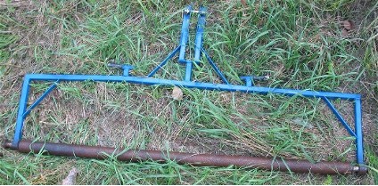

Not a stripper...a striper. You know - the roller behind the mower that bends the grass down.
Thinking of a 3 point version.
Here is a link to something like it. Lawn Striping Accy.

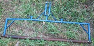

I know that most think this is over kill. Yep - but I had some time.
Here is a picture of the striper. We have had such a drought here in Wisconsin that the sucker has been sitting. By the way - you would not want to connect the top link. That would force the unit to carry some of the mower weight. Not good as I found out. It does work very well (had one chance to use it when the grass was green). One guy I worked with drove by and said - dam% - that lawn looks like a golf fairway.
