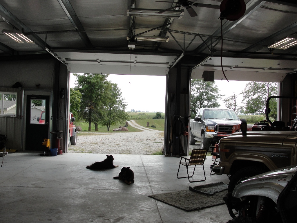

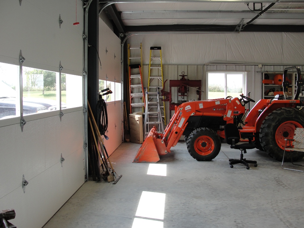

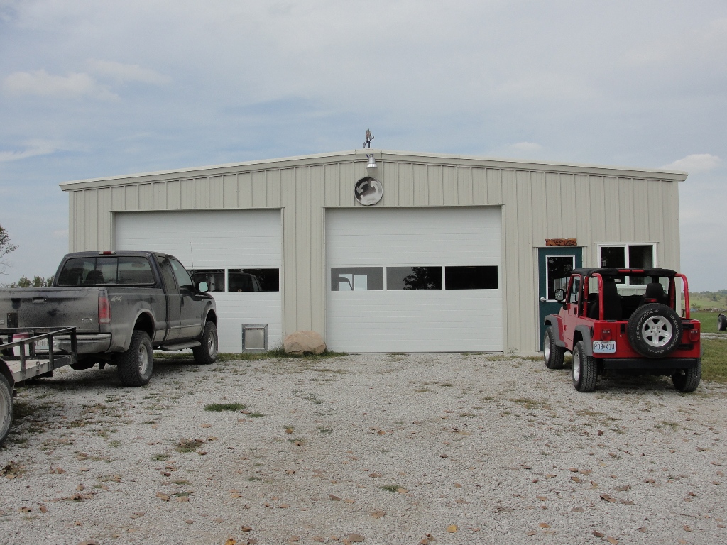

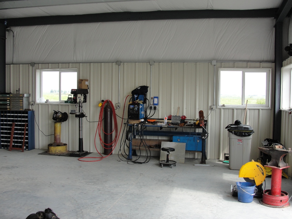

Yeah I think Matt is right, my metal building spans 25 ft. I have three 12' doors. I can park my Kubota and my UTV side by side in one doorway and get in/out easily.
The Super Duty uses all of a 12' door if talking comfortable entrance/exit. My previous shop had one 10' door and one 12', I hated the 10', too small. I can't see using an 18' to park side by side in, gonna be a lot of dented door trim.
My building is 42x50. I understand the desire to keep the welding area separate, that was one of my goals as well. Good luck with your design. :)
