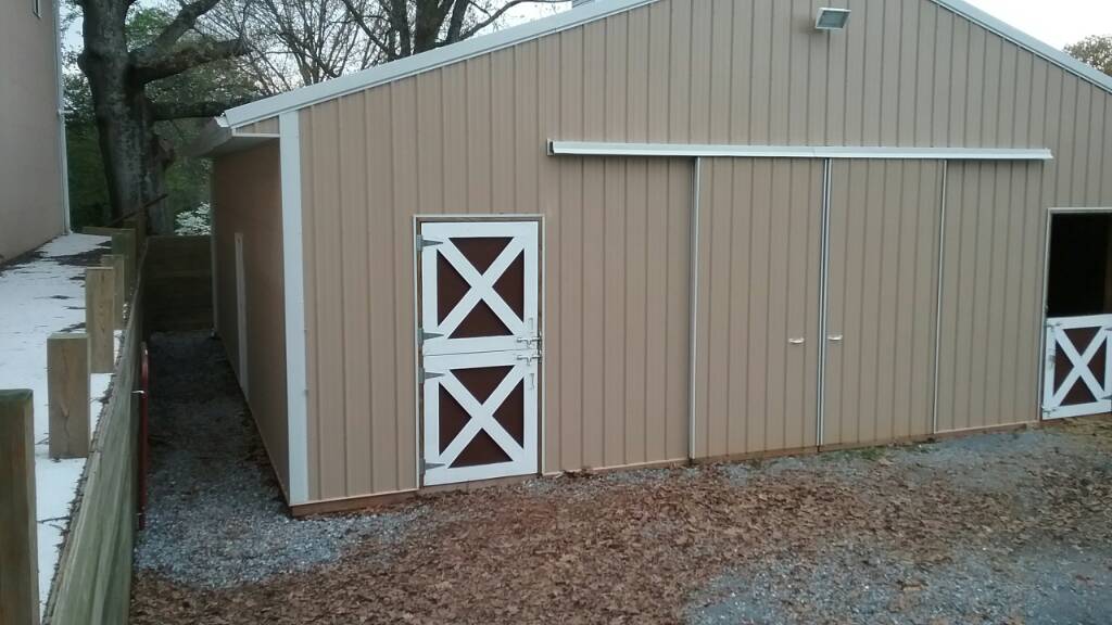

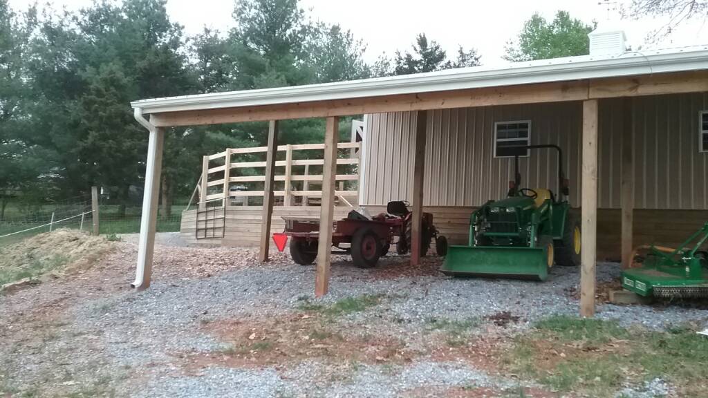

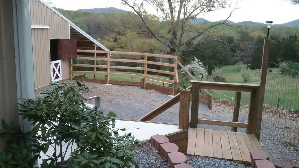

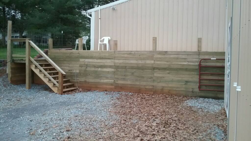

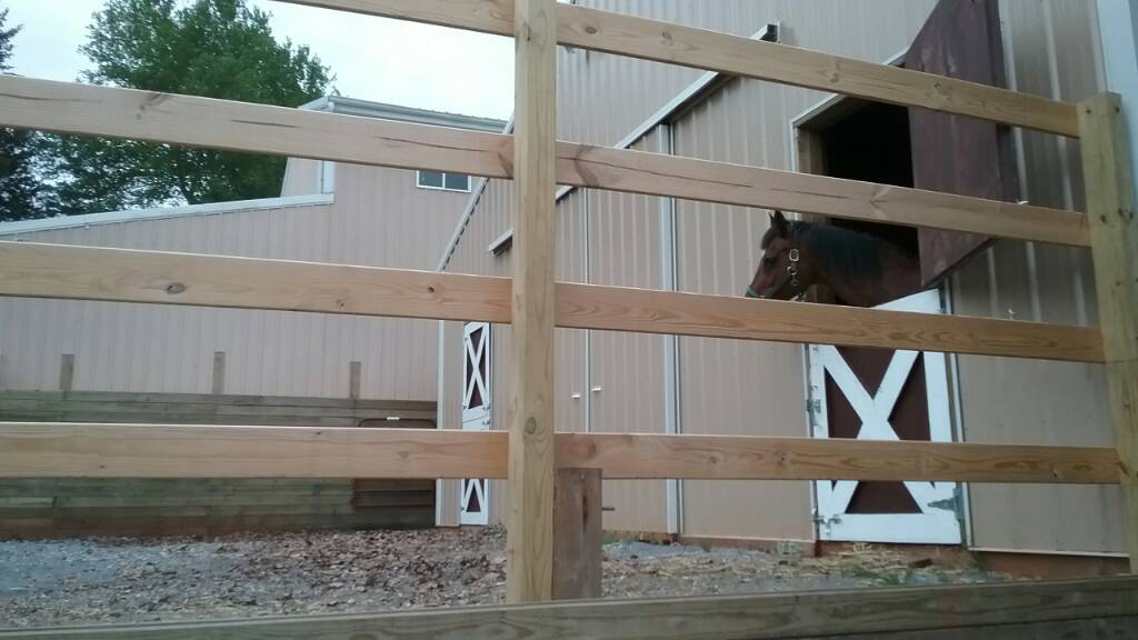

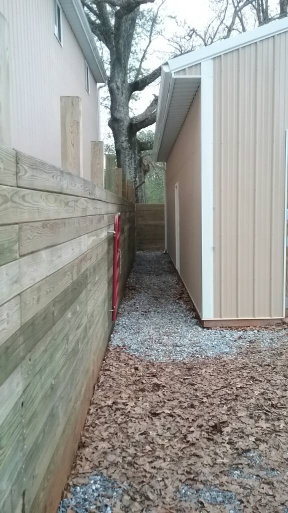

   / Building on a hill #5
This was completed last Fall. A fellow with a 30 ton Cat dozer did the leveling, grading. He was off 1/2" end to end.
Retaining wall is 7ft, then 36x36 horse stable with 36x32 shed overhang.
There's another 4ft retaining wall below stable.
It's behind a 2 story garage same contractor built years ago. Concrete floors.
Really turned out nice on hillside, no water problems. 20200408_191021.jpg20200408_191034.jpg20200408_191111.jpg20200408_191135.jpg20200408_191303.jpg20200408_191324.jpg
