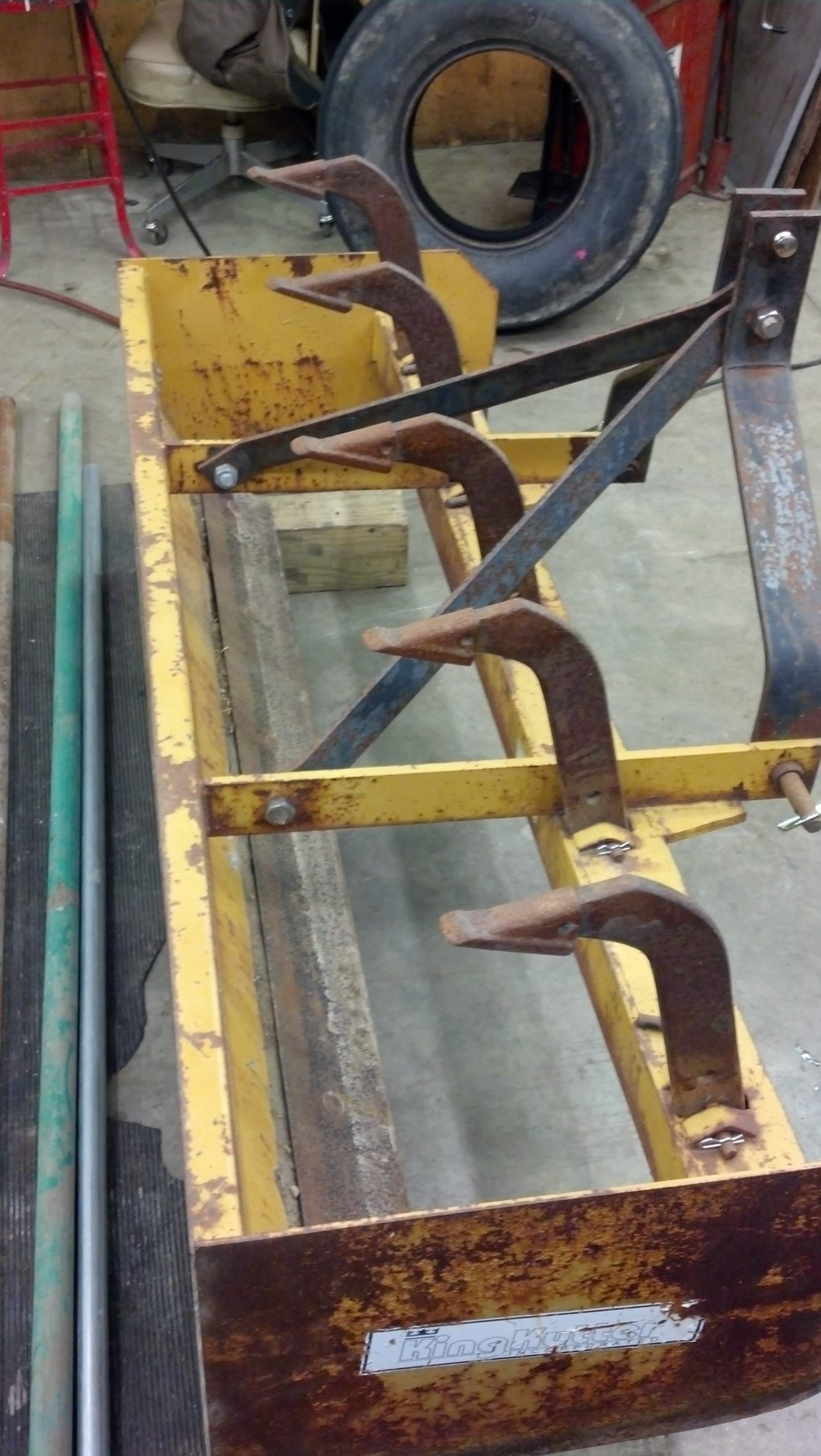

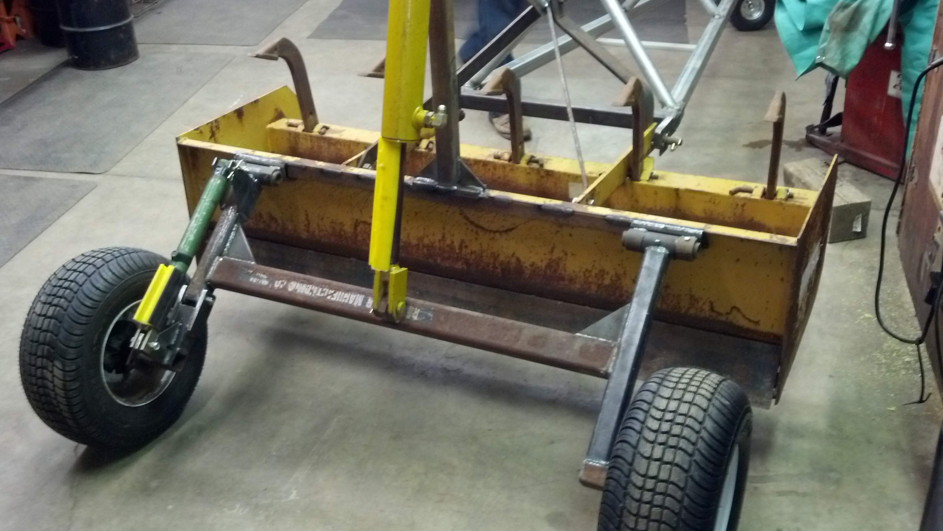

We decided we needed a pull type scraper for grading. so, bought a 4.5 foot box blade and started work.

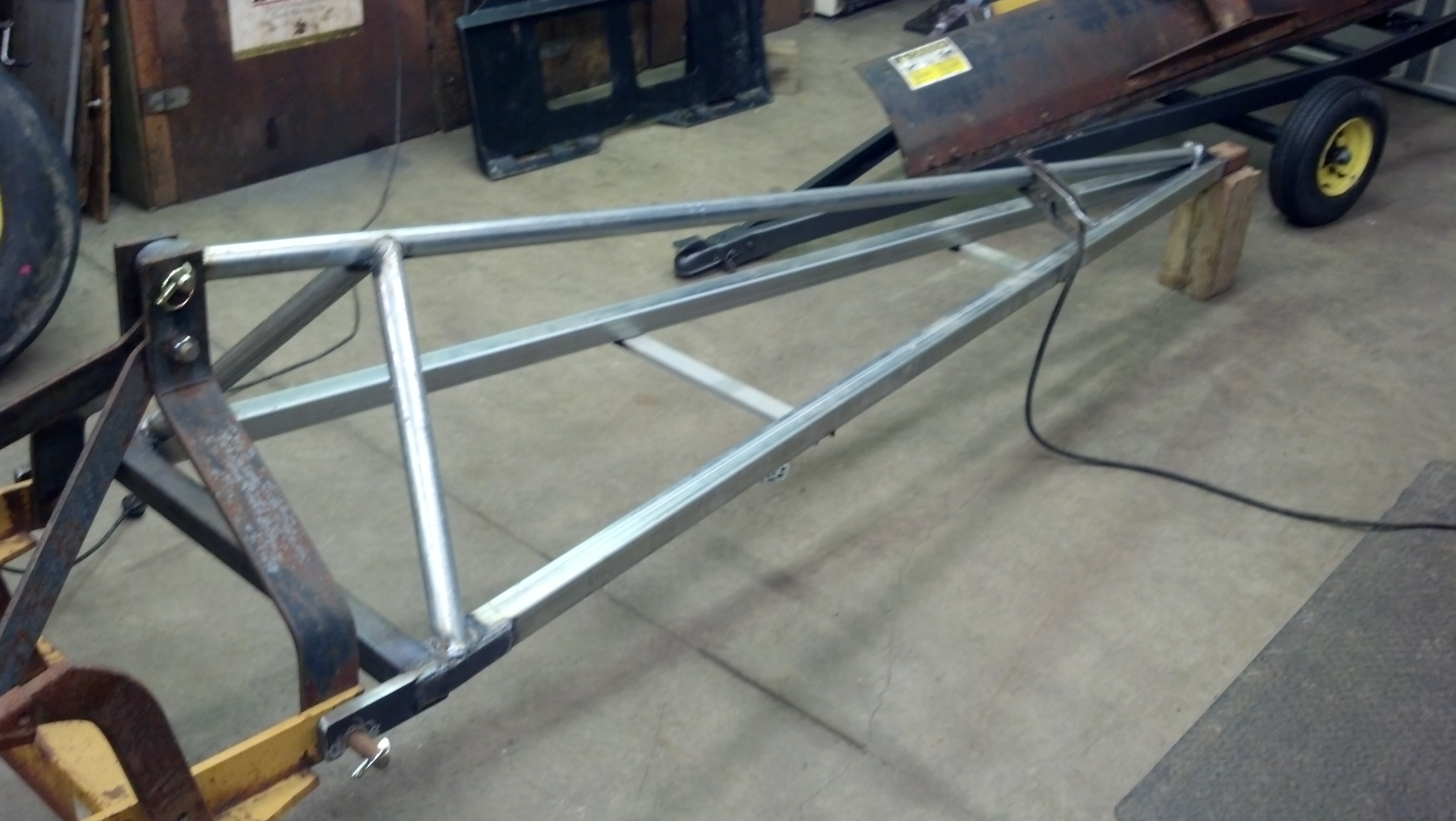

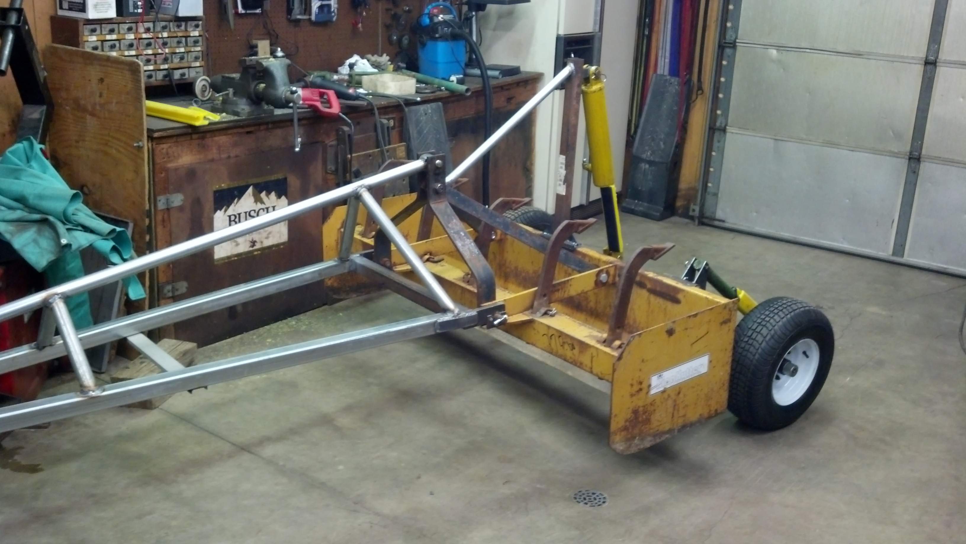

Welded up a attachment system for the tongue.
made the tongue out of some galvanized we had laying around.
it is detachable. so that we can still use the BB on the 3pt if we need too.

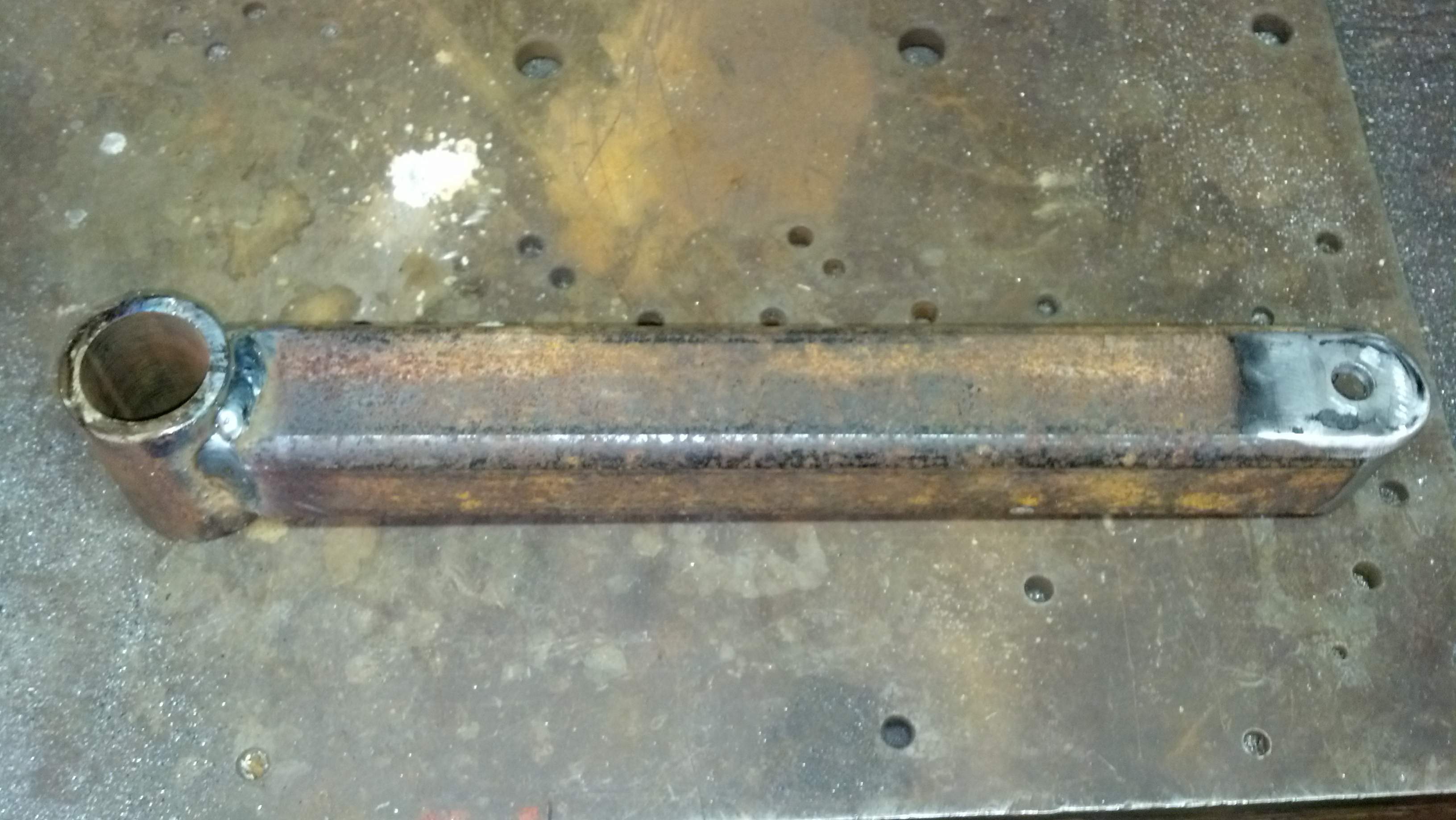

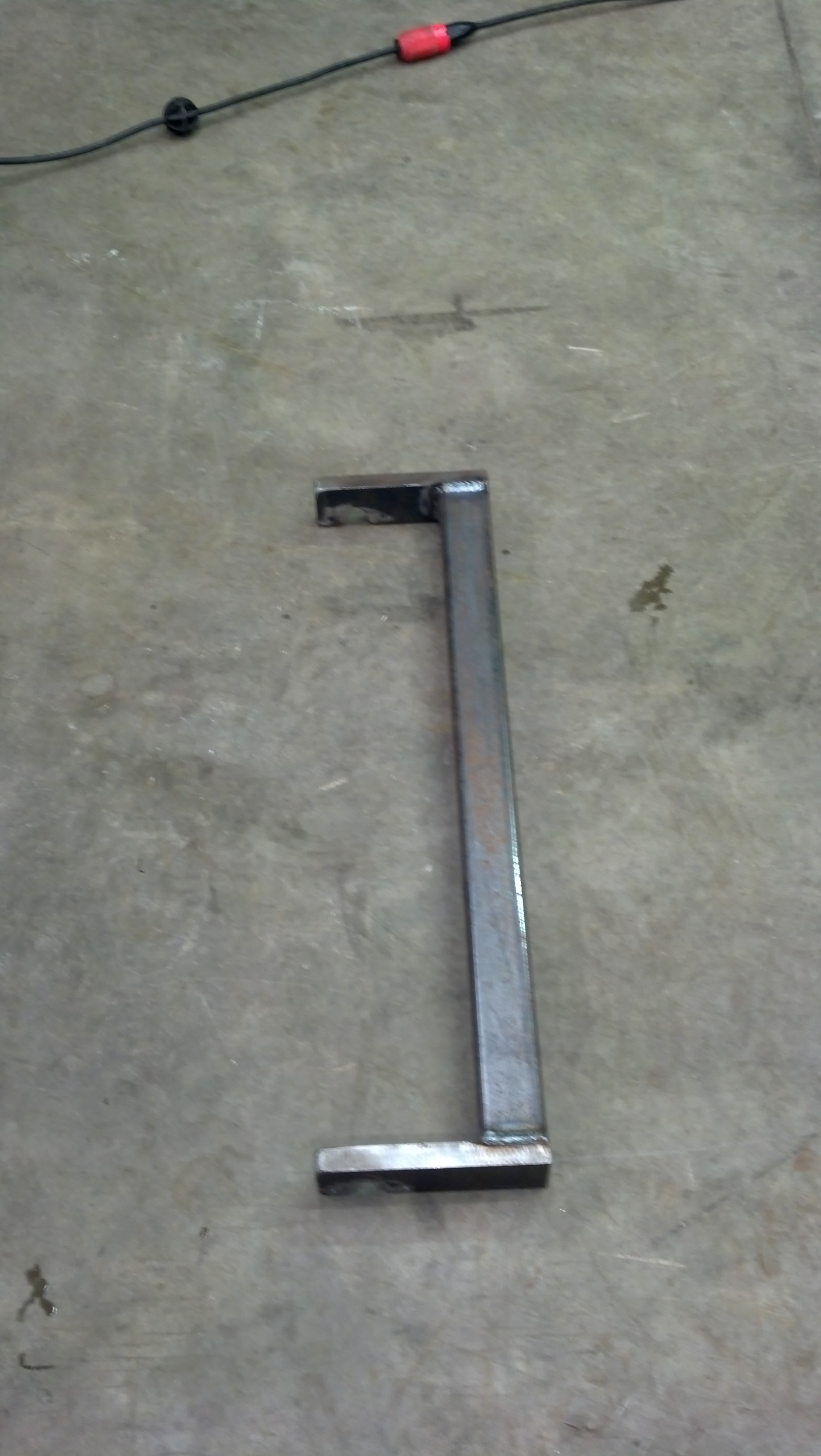

here is one of the rear lift arms.
2x2 1/4 wall welded to a piece of 2" DOM that will be drilled and tapped for grease zirk.
this one will have a small cylinder to create the tilt function.

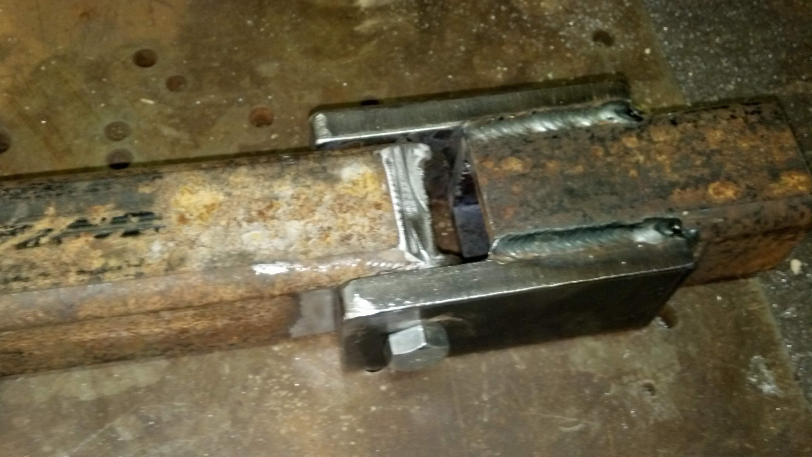

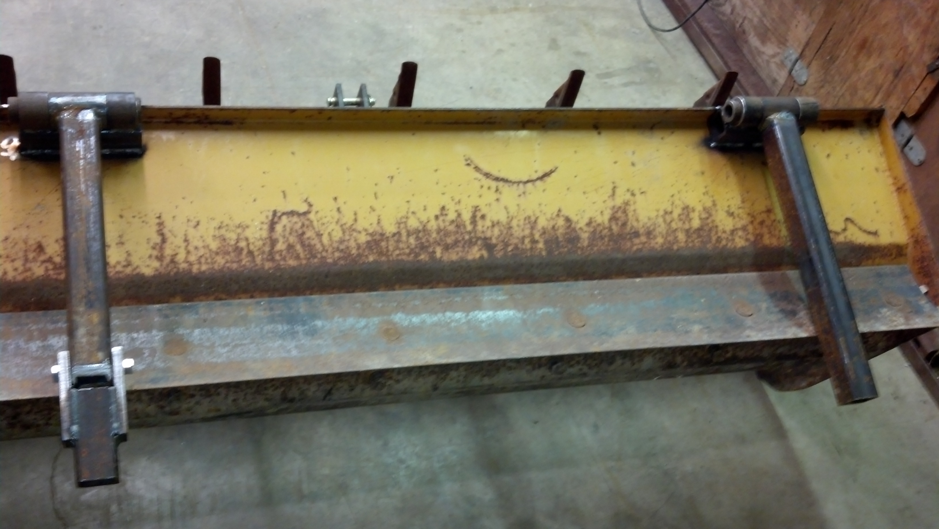

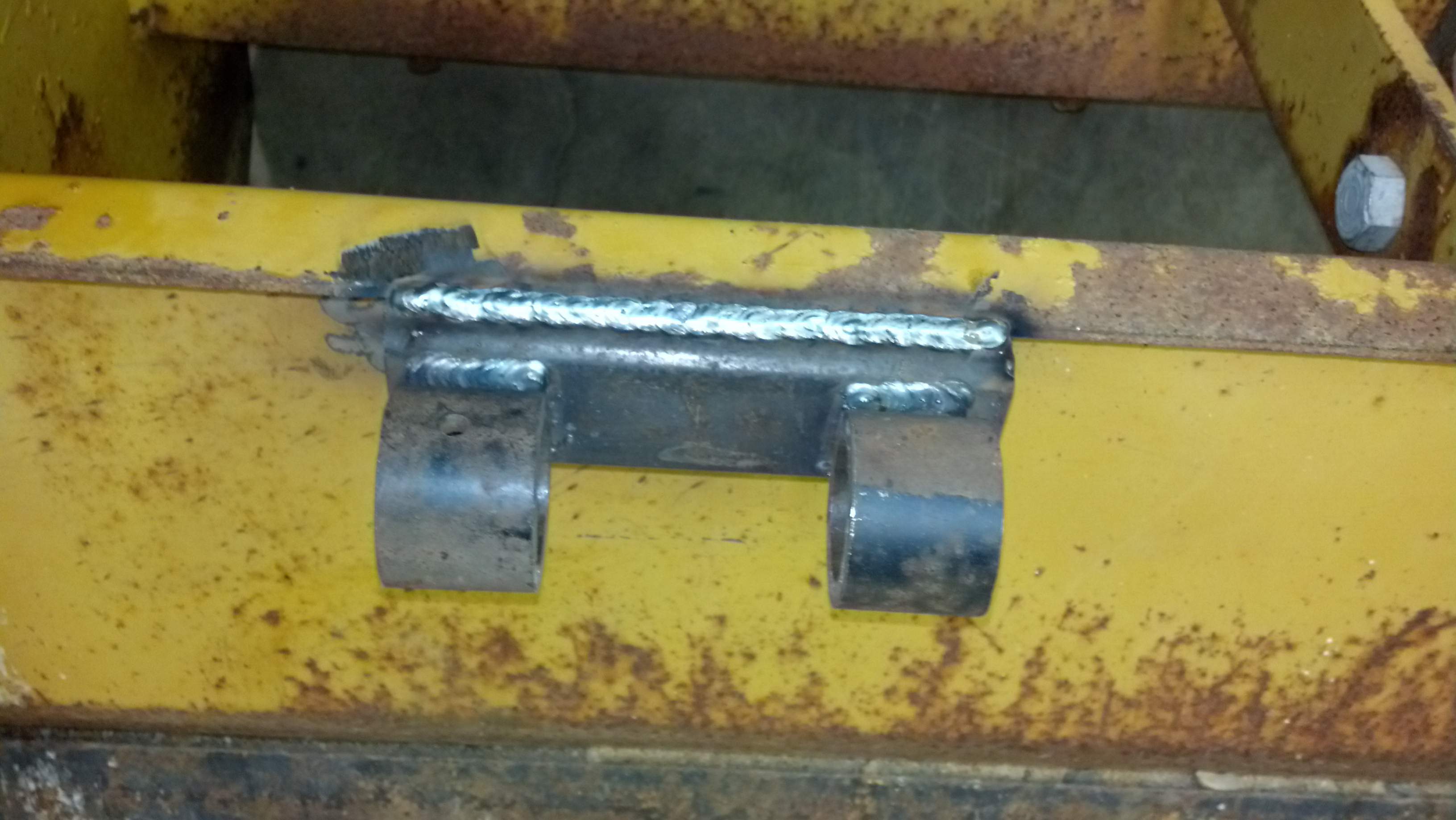

welded another piece of 2x2 to the BB with DOM bushings welded to it.
Both Lift arms attached.

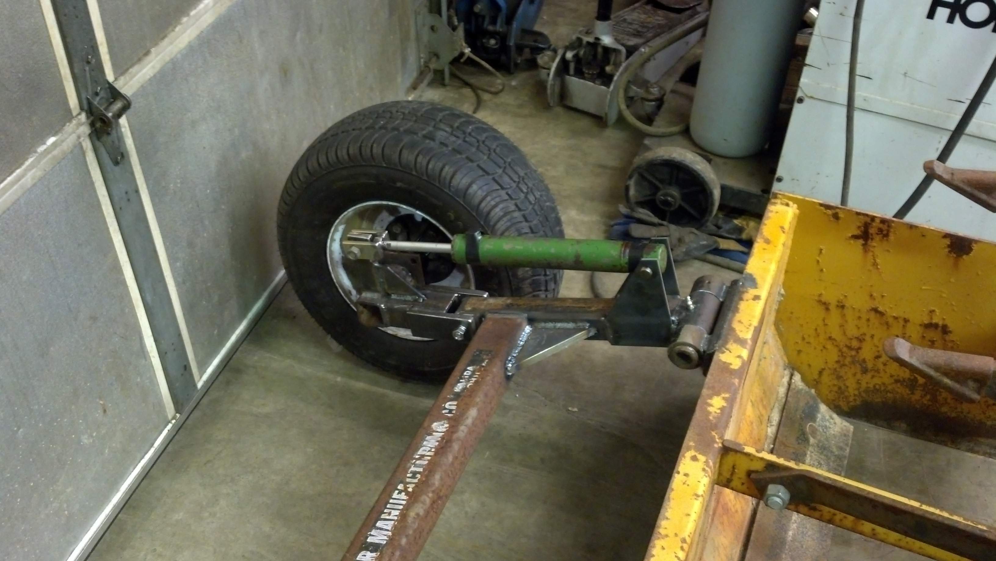

The end for the left Lift arm, this has the tilt cylinder.
The Tilt cylinder installed.
The rear Lift arms mostly finished.
Mostly Finished just needs Paint and Hydraulic Lines.

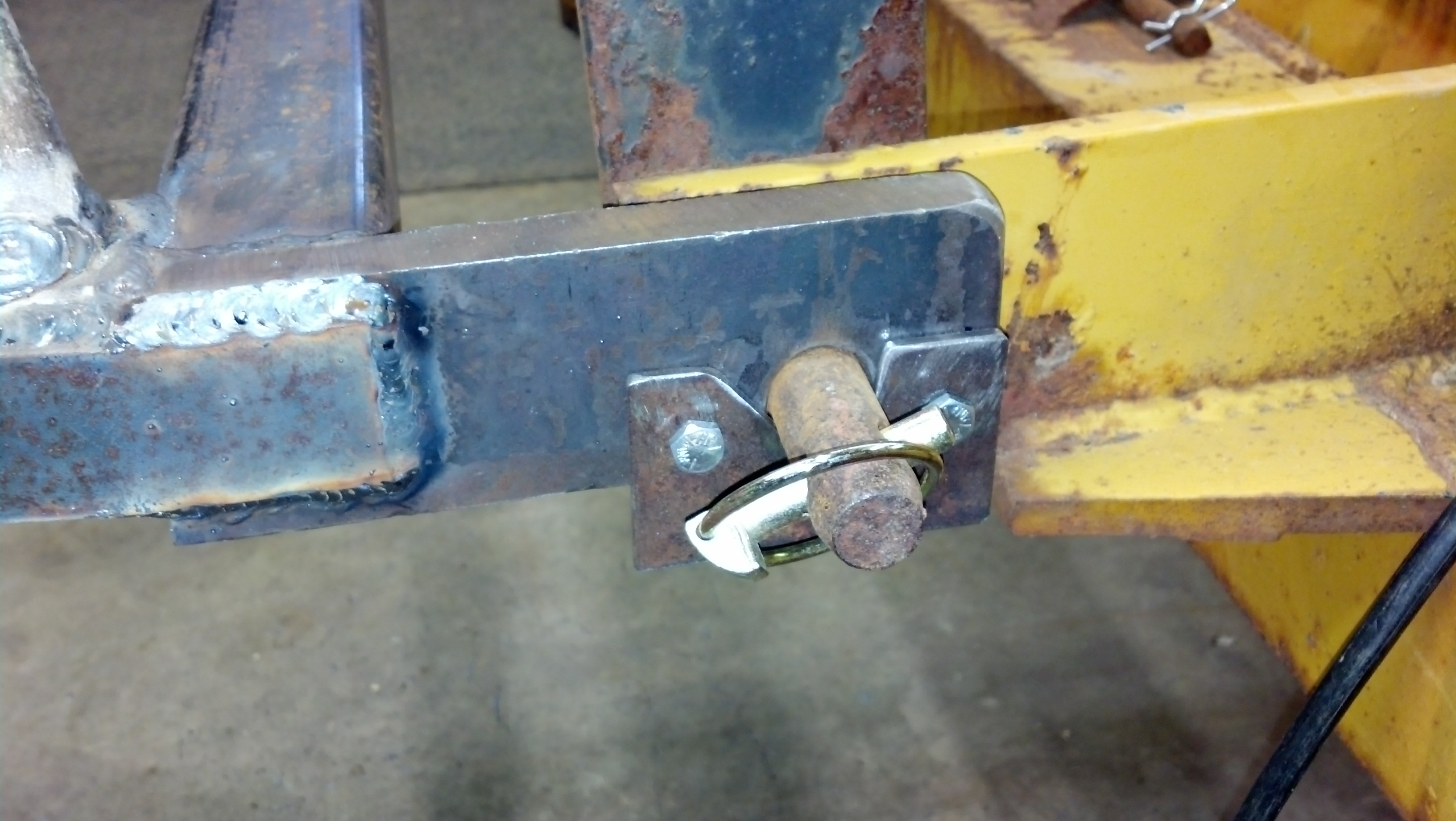

   / Building pull type Scraper from BB. #5
How do you get it off the lower 3 PH pins. It looks like it is too tight to move far enough to drop one side.
   / Building pull type Scraper from BB. #6
The bottoms look like they are just notched out, undo the top and lifts out
thats basically it, its a piece of 3/4" plate notched and a piece of 1/4" with a notch the other way that swings up and pins in.
