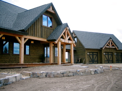

Does anyone have experience doing this and if so any words of wisdom.
My project is a 4 foot wall apx. 40' in length. I have a Branson backhoe with thumb.

Having just placed some 20 ton of stone around our place, I can add some thoughts.
1: Make sure to use appropriate sized stone. In our case, I used what is called "dry stack" ie. bed depths over 12 inches. It's essential to use substantial sizes to provide enough support. You'll have to use your backhoe and thumb to handle this material.
2: Scatter all your stone across a open space so you can quickly find the right rock to fit the next section of the wall. You don't want to just whatever stone is next in the stack.
3: Bed the base layers in several inches of sand and pack firmly around the stone. Backfill behind the stone as you build the wall up. I think four feet is about the height limit to building rock walls in the manner.
Hope that helps. Some pictures will follow.
   / Building rockery walls #3
4 foot high wall in driveway island
   / Building rockery walls #4
2'-3' walls around flower beds
   / Building rockery walls #5
Stone slabs steps and 2' wall around entry

I have built plenty 4 foot rockeries. 4' is the limit of when you need a building permit in my area. I use half man quarry rock which weigh 50-100 lbs. Mine were dark basalt. It cost a penny a pound and I used truckloads.
-Use a 6:1 batter meaning a 6' wall needs to be sloped back into the bank one foot.
-A rock wall is for erosion control, not a retaining wall, so be sure that the ground is stable.
-I keyed the bottom row half a rock deep and then worked in rows. After each row was done I would backfill the wall to the top of that row.
-Your fingers will hurt. You will lift each rock 5 times before you're done. You will notice your rock placement improves about half way through the job from skill and then gets worse as you run out of good square rocks.
-Using a machine is cheating. But if you do, bigger rock goes in faster but looks less cool.
-Keep the kids off the wall. They'll knock the top rows loose.
