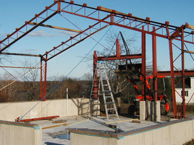

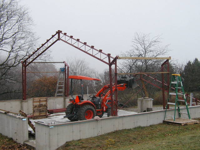

Short story long... I bought a Miracle Truss steel building, before I bought it I was told that none of the trusses weighed more than 125lbs. I figured that with some scaffolding, 3 guys could lift that into place safely. Well... when the building arrived, 2 guys could hardly lift one of the roof trusses, never mind safely wrestle with one up some scaffolding into position. Turns out the trusses weigh about 225 lbs each!! :eek: The first of several lies from Miracle Truss. :mad: So I built a 6ft boom to go on my bucket, but I was not sure if the weight being that far out front would my Kioti CK30 be able to lift it. Well, with 2 trusses bolted together, ~450lbs, I can lift them up. I can't curl the bucket, but I can lift it. I did find that if I partially curl the bucket before lifting, then lift it up so the weight swings in nearer the bucket, I can then curl the bucket the rest of the way. But no way can I curl it with the boom level and the weight 6 ft in front of the bucket. :eek: Looks like my band aided KL130 is going work. So much nicer than driving an hour to the nearest rental place to get a lift. I need to get them high enough so the peak is at about 15 ft.
First picture is the pieces that made up the boom.. the others are the boom in action, at least testing to see if it is going to work. :) Ropes are there to keep trusses from swinging when I transported them from the side yard to the back yard.

My dealer made up a 2" hitch receiver, from photos I gave him from that thread and he threw it in with the tractor when I bought it. I then bolted the receiver on to the bucket. I extended the 2" strap to be used for where the chain attaches. Since that strap carries most of the load, I doubled the end where the hook actually attaches.
For moving the trusses around the yard, I rope them to the bucket so they don't swing. I also keep them only 1ft above the ground so I can drop them in a hurry if I have to. When I actually go to lift them into place, I will have a person at each end, with ropes, to keep things under control. I have great respect for what could happen if one of those 450lb trusses got to swinging around or broke loose and fell.

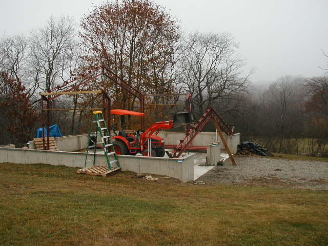

I am able to lift the trusses up enough to be able to position them. :) I lift the trusses to the upright position and set them on the walls to get be able to reposition the lifting straps. I can then lift the trusses high enough so that I can set them in position.. it clears by 3"!! :) The pallet under the ladder provides a more stable platform for the latter on the sloping ground, and gives me another 6" of height so I don't have to climb to the top of the ladder.

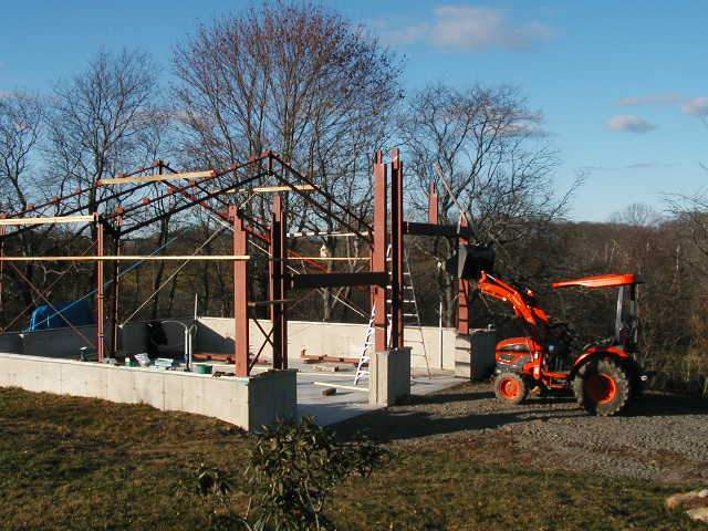

Progress continues, at least it was until the rain and winds moved in. :( The garage is a 30x30, this is the first time I had a vehicle in it... I already wish I had built a larger building. I am already planning my next building... I think it is going to be a pole barn... more margin for error. With the steel building all the footings needed to be in exact position... which my concrete contractor did a poor job at which made getting to this point a long painful road. :mad:
